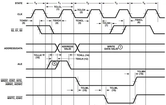

From Renesas 82C88 CMOS Bus Controller
Command Outputs
The advanced write commands are made available to initiate write procedures early in the machine cycle. This signal can be used to prevent the processor from entering an unnecessary wait state.
The standard CPU cycle takes 4 clock cycles. 1st clock cycle Address and ALE.
The standard write cycle is just 1 clock. Advanced is 2 clocks. The signals are active low. Address/Data is just for reference only.

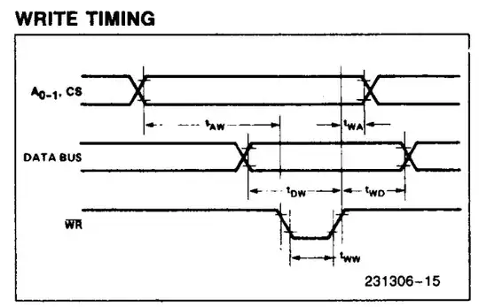

From 8253 data sheet enter image description here
Notice there are no clocks here. The timings for the write signal are referenced to rising edge of write signal. The minimum write pulse \$t_{WW}\$ is 400ns, but the minimum data set up for write \$t_{DW}\$ is 300ns and the data hold time \$t_{WD}\$ is 40ns.
This means that the write data does not have to be available at the start of the write signal, but must be available 300ns before the rising edge of the write signal. The write signal is active low but data gets latched on rising edge.
Now the advanced write signals are used to allow for more time to complete the write or external circuitry will have to insert wait states. I/O devices were slow so wait states had to be inserted.
8Mhz 82C88 part means each clock cycle is 125ns. Even using advanced timing, the write pulse is only 250ns, which is not compatible with a 400ns 8253 write, so 2 wait states must be inserted (375ns < 400ns, so write is 500ns long). Wait states delay processor by additional clock signals to make processor compatible with slower devices.

  • I am ashamed I did not pay attention that setup and hold times were given relative to the rising edge of WRITE. Now it is clear to me why "This [advanced] signal can be used to prevent the processor from entering an unnecessary wait state.", because normal ones which are shorter, are going to give less setup time for a target device. – Linol Jul 17 '22 at 21:15
    Yes. Different devices from different manufacturers and families had different setup and hold times. Advanced just allows more time, hence usage in IBM PC. – StainlessSteelRat Jul 18 '22 at 02:54
