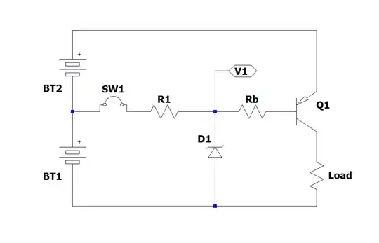

current regulator circuit
I want to build a circuit that supplies constant current to my load.
In theory, the PNP transistor is in its active state when the switch is closed. D1 and R1 will reach a stable point on the Zener diode's characteristic curve (e.g. voltage \$V_1\$, current \$I_1\$ across D1.)
This will supply a constant current (\$I_b\$) to the base, which will fix the emitter-collector current to a \$\beta\$ multiple of \$I_b\$ over a wide range of voltages. The reason I'm using a Zener diode is because BT1's voltage drops over time which will affect \$I_b\$.
I predict the current to the load to be: $$ I_{\text{Load}} = \beta \frac{V_1 - V_{\text{BC}} - V_{\text{Load}}}{R_b} $$
Can the Zener diode maintain a stable base current and regulate load current as expected?
Is it sufficient to determine \$V_1\$ by load line method using only BT1, R1 and D1, ignoring the rest of the circuit?

    The temperature coefficients of the zener and Vbe, as well as the part-to-part variation in beta and several other factors make this idea impractical. A better alternative would be a current mirror, and better yet an op-amp/bjt or FET current source. – John D Jul 07 '22 at 16:44
  • If you want a single BJT stage with a collector current as constant as possible you should be aware that the BJT is a voltage-driven device. Therefore, use a low-resistive voltage devider at the base (advantage: Base voltage nearly independent on the base current and its pretty large uncertainty) and use a current stabilizing emitter esistor RE. – LvW Jul 07 '22 at 16:59
  • @JohnD I read that beta can increase with temperature: https://electronics.stackexchange.com/questions/490868/will-a-bjt-blow-up-if-there-isnt-any-load-resistance-either-in-collector-or-emi, but there seems to be a way to counteract it by adding an ohmic load to the emitter. The resistor-zener series appears to be a standard circuit used for voltage regulation. As I see it, the zener diode circuit and transistor circuit work fine on their own. Is putting them together really so impractical? – coulombs Jul 07 '22 at 18:06
  • @coulombs With an emitter degeneration resistor you could improve the circuit. Since you haven't added any performance specs or requirements it's hard to comment beyond that. The early effect, the previously mentioned tempcos, and part-to-part variation if you're building more than one of these will all impact performance. – John D Jul 07 '22 at 18:47
  • @coulombs For constant current design using discrete BJTs, consider reading [this](https://electronics.stackexchange.com/a/481317/38098). – jonk Jul 07 '22 at 19:37
  • You can achieve a pretty good constant current source with 2 transistors. i.e. https://www.edn.com/circuit-achieves-constant-currentover-wide-range-of-terminal-voltages/ – Kyle B Jul 07 '22 at 20:09
    Why two sources? – DKNguyen Jul 07 '22 at 20:10
  • Zener only is not really a "good" idea ... Zener series with a diode should be a better "device". Zener has a "positive" temperature coefficient (if the bias point is well chosen) and diode has a "negative" temperature" coefficient ... So the temperature effect can be "compensated" ... – Antonio51 Jul 08 '22 at 15:35
  • @Antonio51 That’s not entirely true. They are flat around 5 V. – winny Jul 11 '22 at 18:24
  • Right. At one "voltage" ... Temp Coeff of Zener can be "equal" to zero ... :-) I forgot. – Antonio51 Jul 12 '22 at 11:34

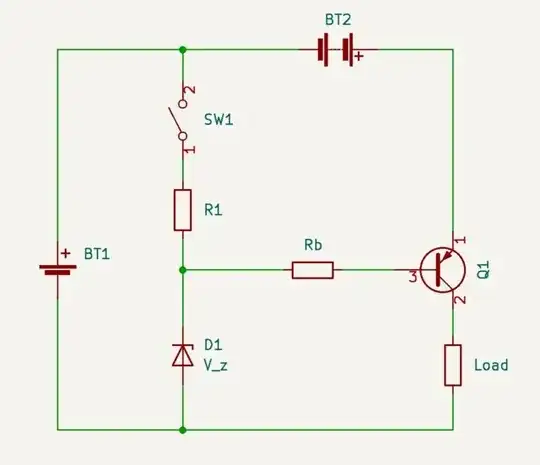

This is your circuit redrawn. enter image description here It appears that you are trying to feed the base of the transistor with a Zener regulated voltage, the problem is that this voltage is referenced to the collector of the transistor through the variable load, when it should be referenced to the emitter through a fixed resistance.
In order to do that you could swap the emitter and collector, but to do that and keep the diode and battery polarities the same you would need to switch to an NPN transistor. You would also need to add an emitter resistor and move the load. Here is the circuit with those changes: enter image description here This will make it regulate the current much better than the original did (which was pretty much not at all) but it's got room for improvement.
A few ideas:
  • Do away with one battery and connect R1 to the positive of the remaining one.
  • The Zener can be replaced with a regular diode or LED, but with the anode and cathode swapped.
  • You could also use a better CCS topology, such as a two transistor CSS.
  • If you still wanted to use a PNP transistor you would swap the polarities of the batteries and diode.
There are plenty of constant current source designs out there, some use a Zener, some other types of diodes, some use another transistor. You can also control the current to a load by adding a current sense resistor and using an opamp to sense the voltage across it and drive a pass transistor. Do a bit of research into current sources/sinks and current sensing, that should lead you to some better ideas.
GodJihyo
  • 17,628
  • 45
  • The denominator in my equation is the resistance of the base resistor, not the resistance of the load, so our equations are different. Also, I should mention that my load is non-ohmic. I suspect that there might be some other mistake in my equation. Thanks for helping me check. – coulombs Jul 07 '22 at 17:47
  • The circuit diagram you made is different from the circuit I am asking about. Please refer to my original diagram and question. I appreciate your help, but you won't be able to provide a relevant answer unless you understand the circuit. – coulombs Jul 07 '22 at 20:50
  • @Godjihyo: Schematic diagrams are usually drawn with positive power supply at the top and ground at the bottom. I think non-ohmic refers to a non-linear load, like an incandescent lamp or diode, which do not have a fixed E/I relationship. – PStechPaul Jul 09 '22 at 04:36
The answer is "no". Zener can only fix the Base voltage.

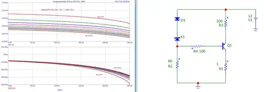

If you give the value of BT1 and BT2, it is possible to show what one can expect ...
If you move the Zener, then one can expect a "constant" current.
See this example.
