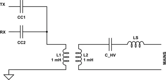

Depending on the band you are working on (e.g. PRIME) and the load you are trying to drive (can be as low as 2 Ohms - basically you can think of the load as the distribution transformer), you may need to place a series inductor:
Above is a simplified schematic of a coupling block. Magnetising inductance of 1 mH is a typical value for PLC coupling transformers (NB: None of the bands' operating frequency reach 1 MHz - typically 40 kHz to 150 kHz depending on the band):
In your case the load is the voltage source (possibly V1) which is theoretically 0 Ohms. So it's quite normal that you can't transmit any messages. You do need to model the voltage source properly and consider using the series inductance.
