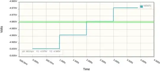

You can alter \$V_{ADJ}\$ to vary the output offset, and simultaneously compensate for the op-amp's input offset voltage. I've set \$V_{ADJ} = {5 \over 3} V \$ here, with no attempt to compensate for \$V_{OFS}\$, because I want you to see the vertical shift of output due to \$V_{OFS}\$. Here are the graphs of input and output:
As you can see, each step in the output is greater than the desired value by an amount \$4 \times V_{OFS} = 4 \times 200\mu V = 800 \mu V\$.
