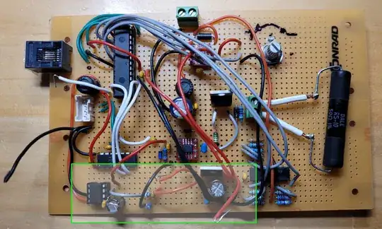

This is what the prototype looks like for the moment. I've highlighted the area where the DC conversion is:
Circuit prototype with MAX632 Boost converter in green rectangle

The inductor was definitively very far from the IC. Also others commented about my loose layout. So, first thing I removed all components, and placed them a bit more together:
Layout A
New layout is similar to my original layout, minus all the dangling wires, plus the inductor much closer to the MAX632 chip, plus a star layout for power wires. Each module has a decoupling capacitor between power and ground. This schema gives a rough idea:
Star Layout with wires

    @jmgonet like others have said, I would first recommend that you try to tidy your wiring a bit and add a separate sheet as a GND plane. Any filter will be a futile effort with so many wires going everywhere and picking up HF noise inductively. – tobalt Jun 27 '22 at 05:29
There are two very good answers already which cover measurement technique (to make sure the noise is even really there and as bad as you think it is) and layout (keep those loop areas small!).
You will need to observe and follow the tips I’m both of those answers to get a good result.
But you seem to be asking what can be done circuitwise to reduce the noise.
For anything over 50MHz (sometimes even lower), there is a secret weapon that can often solve the problem all by itself.
Ferrite Beads
These little ferrous nuggets of magic are often overlooked and in my opinion one of the most underrated circuit components. Don’t mistake these for inductors, for they are not. They have some inductance naturally, but their saturation current is so low that under even a little DC bias, they are barely inductive.
However, that ferrite core is engineered to have very high hysteresis and eddy current losses above a certain frequency. In other words, ferrite beads act as frequency-dependent resistors and will dissipate high frequency noise as heat. The actual power contained in these harmonics is usually quite small, so it won’t generate an appreciable amount of heat. But just like a linear regulator, burning the noise off as heat is the most effective way of removing it from a circuit.
Using a suitable ferrite bead just before the load (so after the LDO’s output), with 1-10nF of ceramic capacitance on either side of the bead (forming a pi filter) will clean up a large amount of the high frequency noise. And if there is still too much, just use additional beads in series. It is totally possible to achieve 1uVpp or less of noise, at least at frequencies above which the ferrite bead is effective.
Do not use a low pass filter
…unless you fully understand the consequences for doing so in the context of voltage regulation.
Using a low pass filter on the output of a voltage regulator (linear or switch mode) will also and potentially severely degrade the load regulation and the transient response of a given regulator. In some cases it can even cause instability or oscillation.
You can use one tuned to the switching frequency to attempt to attenuate some of that ripple, but it is going to be more complex, burn more power, and likely be less effective than than a simple ferrite bead.
RC Snubbers
…our last, best hope for silence.
This is a technique that can eliminate some of the noise at the switcher itself, but it requires access to the switching node, which as far as I can tell, is not pinned out on this regulator chip. So unfortunately this won’t be an option but it is also unlikely to be necessary. Do take the time to search this site for information on RC snubbers though, as they are extremely effective (but a with an efficiency trade off but usually a manageable one).
metacollin
  • 27,884
  • 64
  • 119
    Pin 4 of the IC is the switch node. – Lars Hankeln Jun 27 '22 at 19:21
    I've ordered some ferrite beads, plus some capacitors to perform the RC Snubber design procedure that I've read in several places like this application note: [AN11160](https://assets.nexperia.com/documents/application-note/AN11160.pdf). I'm eager to experiment those two solutions. – jmgonet Jun 30 '22 at 08:44
To get rid of these HF pulses, you need a filter.
A LC filter is a voltage divider: at high frequencies, L attempts to create a high impedance, and C attempts to create a low impedance.
The best inductive component for this is a ferrite bead. Inductors are optimized for low losses, and ferrite beads for maximum HF losses. This is what you want to turn the noise current into heat. In addition, ferrite beads usually have much higher
Make sure it's rated for and will not saturate at the DC current in your circuit. If it saturates, it'll lose its inductance and become useless. Consider a model rated for use in power lines (not signal lines) and an impedance of 100-300 ohms, that's usually specified at 100MHz. Then check the impedance plots to pick one with a wide impedance peak to filter a wide range of frequency. Here's an example.
Next you need a cap to ground. The self-resonant frequency of this cap is irrelevant. What matters is its inductance (including the layout) which determines its impedance at high frequency and therefore its ability to short the noise into ground. The more inductance the cap has, the higher its HF impedance, and the worse its ability to shunt noise to ground.
Since all SMD caps of the same size have the same inductance, then it depends mostly on size (smaller is better), and the answer in your case tends to be "a reasonably small package that you can hand solder like 0805, and several µF".
Capacitors of 10nF or less are available in COG dielectric, which is compatible with high frequency. However high, COG dielectric self-resonance is around 20MHz (see page 9, COG dielectric) which is below the noise frequency.
A C0G cap will have low loss, low distortion, low drift, etc, so it's a good choice if you make a filter to condition a signal. If you use X7R to filter a signal, it will suck (low accuracy, high drift, tons of distortion, high loss, etc). But for the problem at hand, these parameters are irrelevant, what matters is the inductance of the cap, and the X7R cap will have exactly the same HF behavior, with more capacitance. So it will be better around a few MHz. A physically bigger C0G cap will be worse than a smaller X7R cap. Therefore, X7R is preferable.
Here are a few examples with a random ferrite bead:
Green (top left): bead and 10µF 0805 X7R cap mounted over ground plane with 2 vias (2nH inductance). It's pretty good, -50dB between 1-100MHz for less than 10 cents.
Red (top right): the same with 10nF cap. The lower value of the cap makes the cutoff frequency much higher, and the resonance with the inductive ferrite bead much worse.
Green (bottom left): 10µF X7R in parallel with 100µF electrolytic having ESR of 1 ohm to tame the resonance peak. A good price/performance ratio.
Purple (bottom right): 10nF thru-hole cap, with a lot more inductance. Say it's mounted on perfboard instead of a PCB with ground plane. In this case, the very high inductance destroys the high-frequency performance.
So in order to filter that noise, you need a filter, which requires a cap with good HF behavior (ie, low inductance), which requires a SMD cap over a solid ground plane.
As the others have said, the perfboard construction around the DC-DC routes HF currents through long wire loops which emit lots of electromagnetic fields, which will couple into everything on the board. It is not possible to get rid of it, it has to be controlled at the source, by doing a solid layout on the boost chip over a ground plane.
If you don't feel like doing a PCB for the whole board, you can make a small one with just the boost chip, inductor, feedback, input/output caps, and filter.
bobflux
  • 70,433
  • 83
  • 203
    I think our answers say pretty much the same thing, but in contrast to my wall of text, yours has an image that says it all +1 – tobalt Jun 30 '22 at 16:29
    "_The self-resonant frequency of this cap is irrelevant. What matters is its inductance (including the layout) which determines its impedance at high frequency and therefore its ability to short the noise into ground_" - It makes so much sense, and I never thought it, I feel embarassed. I'm going to have a couple of busy weekends to explore all those solutions. – jmgonet Jul 01 '22 at 11:13
    Hehe, yeah ;) Above SRF the cap becomes an inductor so its impedance increases. So the lowpass response stops going down. But that doesn't mean it goes up! It will only do so when the inductor also gives up. But there's still plenty of attenuation. It starts from the minimum impedance at SRF which is very low, then rises with frequency. So you get a good 1-2 decades above SRF where the impedance of the cap is still low enough to handle the noise. The most important thing is a low inductance connection (one on each side of the cap) to a low inductance ground plane. – bobflux Jul 01 '22 at 12:02
    For DC-DCs it's all about the layout. It's a synchronous boost so the chip will output square wave current into the VOUT pin. Say it switches 1A in 10ns (0.1A/ns). If you have a thru hole cap connected with wires with 100nH inductance on this current path, that's L di/dt=10V spike on the output. If it's a 5V chip, it's gone. If you use a 5nH thru-hole cap right across VOUT and GND, much better. If it's a 1-2nH SMD cap, even better. – bobflux Jul 01 '22 at 12:09
Here are two excellent resources for understanding the problem and potential solutions:
Basically, adding filtering etc. will only work if you spend a lot of effort in designing an optimal PCB layout for RF frequencies, and very careful component choices, etc. (e.g. SRFs of capacitors, ...). Also, passive components like chokes and bypass capacitors alone will most likely not bring the level of attenuation you are hoping for.
A much more promising approach is using a modern LDO regulator with a high ripple-rejection ratio. So you step-up the voltage to a bit higher than what you actually need (like 10.5 V if you need 9 V) and then let the LDO do the magic of filtering the ripples and noise. Some modern LDOs attenuate them in the 60-70 dB region (at lower frequencies).
You will loose some efficiency (because the LDO will burn some of the additional voltage your DC-DC converter produces), but it will be very hard to get such a strong attenuation of the ripples by other means.
Some pointers:
  • TPS7A84 (up to 5V)
  • TLV767, adjustable up to 16V, 1A, 1 EUR, 70 dB
  • LM2940, 9V/1A, SOT-223, 2 EUR, 64 dB
Hope that helps!
