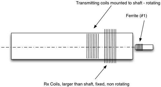

The outer shield of the conductor carrying the return current cannot generate a magnetic field inside the tube it forms hence, the only magnetic field between inner conductor and outer (tube) is generated by the current flowing through the inner central conductor. Try googling magnetic fields within a tube conductor carrying current; the field is zero. Laws of physics.
QuickField simulation of the outer shield (a tube) carrying 1000 amps with the inner wire open circuit: -
Image taken from here. As can be seen, there is no magnetic field between inner conductor and inside of shield tube.
  • Thank you for your answer! Apparently I got confused because I knew that there is magnetic field inside a solid current-carrying conductor and assumed that it is the same case for hollow conductors too. I guess I'll have to do some more reading :) – CapBul Jun 23 '22 at 23:20
