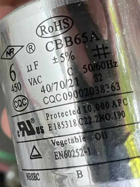

Note: this was a refurbished unit and I do not believe the capacitors are the originals so where would I check what the appropriate sizes are - I don’t see it in the manual and I don’t see 6 uF easily available on amazon or commonly used on other ones, which is why I’m looking at 5 uF on a dual
Here are the current capacitors:

The exact value for run capacitors is generally not very critical, so IMO you will be OK using a 5/35 uF dual capacitor to replace the separate 35 uF RC1 and 6 uF RC2. I recently repaired a very old air conditioner by using two separate capacitors to replace the original dual can. Using a lower value is pretty safe, and may just result in a little less torque or speed for the fan. A higher value runs the risk of higher current in the auxiliary winding, which could result in overheating, but anything within 20% or so should work and be safe.
One way to determine the proper size of a PSC run capacitor is to try several values by adding small capacitors in parallel, and monitor the running current. The proper value should have the lowest current.
