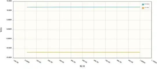

(edit) I ran a parameter sweep for R1 and R2, The simulation shows that the 12V regulator can sink current as well as source, although that might not actually be the case. Anyway, it should be possible to adjust loads on the positive and negative rails so that the regulator will not have to sink current.
Parameter sweep R2: Parameter sweep R2
Parameter sweep R1: Parameter sweep R1
