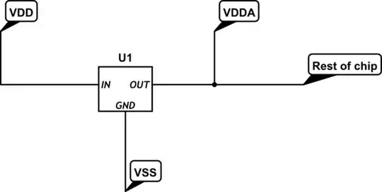

Question 1: Are there any holes one can poke in this circuit:
LM317 power
It's the same pattern repeated with different output voltages and input lines.
I know the resistor values have to be figured out, but it seems this pattern above could be repeated however many times it would be needed to give me regulated output (12V and 5V shown but 3.3V is the same thing just different resistor values) from any input the LM317 supports, and the ATX "PS ON" signal of pulling that pin low to activate the system would work. It needs a timing capacitor for the "Power Good" line and it doesn't support the -12V rail. Let's assume those things are okay for my setup. And I know I'll need to cool this thing probably with one or more fans.
And I would then just repeat the above circuit pattern for 3.3V and for however much output power I wanted to support in order to get my expected outputs and current (which so far as I can tell is somewhere around 20A on the 3.3V and and 5V outputs and 15A on the 12V output). The LM317 datasheet shows an example of parallel supplies (page 16, figure 22) and from what I can tell as long as I have the outputs tuned correctly so each of the LM317s for a given voltage matches exactly at their ADJ pin, and I have this 0.2 Ohm resistor the datasheet shows - seems like I could get the required current.
Does this seem sensible? It looks like this would work but I've just never designed something to carry this much current, and I'm looking for a sanity check and hoping if I'm doing something crazy here I can find out before I learn the "hard way" with smoke and sparks and fire extinguishers.

  • You know an LM317 absolute maximum ratings for current mean that it can only supply 18W at 12V. How are you planning on making that work with a 250W supply? – user1937198 Jun 19 '22 at 22:27
    Why on earth are you using linear regulators in this design? Are you trying to build a space heater? – brhans Jun 19 '22 at 23:00
  • @brhans Because I pay the same cost for cooling in the data center, lol. Joking aside, I assume you're suggesting a switching regulator instead - so something like https://www.onsemi.com/pdf/datasheet/mc34063a-d.pdf ? – bgp Jun 20 '22 at 00:43
  • @user1937198 The idea is to run multiple in parallel to provide the necessary current. – bgp Jun 20 '22 at 00:44
    Are you really planning on using over 30 regulators? And It doesn't matter how much you pay for air con, you still need to get the heat out of the ICs. A switching regulator with an external switch would make a lot more sense for regulating 21A. – user1937198 Jun 20 '22 at 01:51
    You've also mis-calculated your required transformer if you use linear regulators. Current in equals current out, so if you want 20A out you need something more like a 500VA transformer, because the linear regs throw half of that away as heat. Just look for some switching power supplies, preferably ones which are capable of being paralleled without any extra mods. – brhans Jun 20 '22 at 01:55
