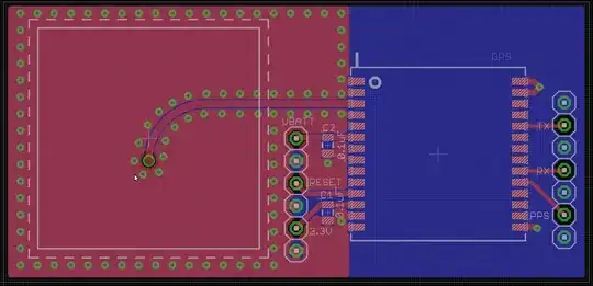

Here is a screen capture of what my board looks like:
Both the area fills (top and bottom) are GND, and I stitched vias approximately every 75 mil intervals between the top and bottom ground planes all around where the patch antenna is placed and along side the antenna feed to the GPS module. I didn't have any guidance on how to do this properly, so I just kind of eyeballed it. Perhaps it's overkill? I also stopped the top-side ground plane short of the chip to follow guidance that there should be no traces or solder mask under the GPS module.
The inner solid line square is 25mm and represents the actual patch antenna footprint. The dashed line around the patch antenna is a 27mm square that represents the required ground plane under the antenna, as I read it's datasheet. The feed length is about an inch (which is much less than the wavelength at 1575.42MHz) so I don't think path loss is of any concern here. I rounded the feed path it to "avoid sharp corners." I reckon that doesn't really matter too much, but I figured I may as well. Finally I used a 0.9mm drill size for the antenna pin, which I intend to solder on the back side. Does that all seem sound?
If I haven't given adequate background information in some regard, please let me know in a comment and I am happy to add information as necessary if I can. Just looking for an objective review as these are topics that I don't consider myself an expert in, and I can't think of a much better place than here to find knowledgeable and helpful colleagues.

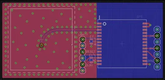

I added a bunch of "random" vias within the ground stitching region under the patch antenna per @Dave's suggestion. Here's an updated board screenshot:

It looks pretty reasonable to me. I've got a question and a comment.
What are the components between the antenna and the GPS module? Any clocks etc? If they are power supply lines, it looks a little light on bypassing.
I'd also drop a dozen or so ground vias under the antenna itself, placed randomly. The reasoning behind this is to make sure you don't create a resonant cavity under the antenna, with the walls formed by ground planes top and bottom, as well as the via holes running around the outside. Unlikely, as your pcb is likely to be lossy, but you'd hate to hit the jackpot with that.
rfdave
  • 1,821
  • They would appear to be decoupling, and a connector carrying only power and reset. Looks fine do me. +1 for avoiding an accidental cavity. –  Mar 26 '13 at 09:26
  • The only things between the patch antenna and the GPS module here are two 100nF capacitors for bypass decoupling on the VBATT and 3.3V inputs to the receiver module supply inputs. The header pins between the module and the antenna are to connect an external reset, and to bring in VBATT and 3.3V to the board. – vicatcu Mar 26 '13 at 13:39
  • I added random GND stitch vias per your suggestion and added an updated screen shot to the question under the heading UPDATE. – vicatcu Mar 26 '13 at 15:01
