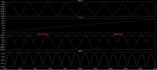

Case1: OUT Series res = 10 ohm -> spiky input current reaching upto 15 A -> capacitor charging fast enter image description here After a long time: enter image description here
Case 2: OUT series res = 100 ohm -> almost sinusoidal input current reaching up to 1.6 A-> capacitor charging slowly enter image description here After a long time: enter image description here
Looks like the behavior is same at steady state - whatever be the resistance.
Can the same approach (dynamically vary resistance to maintain constant current) be used to limit inrush current?

    You are not using/simulating a load (i.e. a restor in parallel to C1). This schematic is useful to generate a *voltage*, not a *power supply*. When a load is present, things change dramatically. – linuxfan says Reinstate Monica Jun 13 '22 at 15:53
  • @Rohat: Yes, it is related. Since I didn't want to stuff to many questions in a single post, I made this as a separate question. – Divya K.S Jun 14 '22 at 04:38
