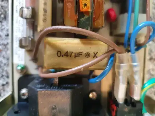

I have an Apple IIE that I'm trying to bring back to life and in my research, everything suggests replacing the RIFA capacitors in the power supply. I'm looking for suitable replacement RIFA capacitors and wondered if anyone can tell me if I'm choosing suitable replacements? There are two RIFA capacitors in the Power Supply (Astec Components 250v) and they certainly look old and cracked (see photos below)
0.1uf X RIFA Capacitor Details 40/085/56 GPC C6 PME 271 M 610 https://www.amazon.co.uk/Capacitor-Class-0-1UF-Compatible-Capacitors/dp/B084MJV1PR/ref=sr_1_5?crid=1EOB1ST6IIWP3&keywords=riva+capacitor+x2&qid=1654447492&sprefix=rifa+capacitor+x%2Caps%2C74&sr=8-5
0.47uf X RIFA Capacitor Details Can't quite make out the details without removing but I believe also X Class PME 271 M Would this be a suitable replacement? https://www.amazon.co.uk/EVOX-RIFA-CAPACITOR-0-047UF-FILTERS/dp/B09KV9D3TV/ref=sr_1_1?crid=35QD9GWONNU34&keywords=rifa+capacitor+0.47&qid=1654447365&sprefix=rifa+capacitor+0.47%2Caps%2C64&sr=8-1
I'm based in Ireland, I found similar components on sites such as rs-online.com, but they require buying 5 or more and I only need one of each. If anyone has any other suggestions of components sites or particular replacements I should look at it would be much appreciated. Thanks!
0.47uf RIFA Capacitor
[0.1uf RIFA Capacitor2
  • DO NOT replace them with RIFA capacitors. There's a reason these always need to be replaced, and it's because RIFA capacitors tend to fail quite badly. Replace them with suitably rated film capacitors from a better brand like KEMET or TDK. – Hearth Jun 05 '22 at 16:53

  • @Justme RIFA capacitors should always be replaced as a matter of course, they're notorious for failing violently. – Hearth Jun 05 '22 at 19:57
