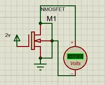

The potential throughout the channel will be the same as S and D (i.e. 0).
This is because that is a continuous conduction region with no current flowing.
The potential across the GOX will be VG.
There is a slight twist to this - if you define '0V' as the V at the external S terminal, then due to work function difference, the actual V will be non zero, but this is not observable.

Potential at the Gate Potential at the Drain Potential at the source
Potential through the drain and source will be zero.
