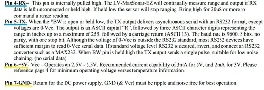

How do you make a range sensor using one transducer:
Datasheet
As you can see from the EZ01 datasheet, it has the ability to do both. It is the same pinout as my MB7380 sensor:
Same pinout

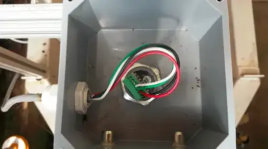

  • Maybe he means water resistant or rain proof. Another way is putting the pinout end in a box like I show. – adamaero Aug 28 '19 at 14:12
