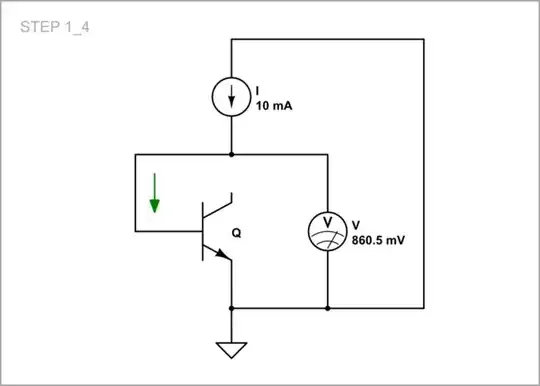

Basic idea. I don't know who came up with the brilliant idea to simply connect the transistor collector to its base (as later, the op-amp output to its inverting input)... but I am sure it was people familiar with Harold Black's idea of introducing negative feedback in amplifiers. This connection introduces a voltage-type negative feedback that has a drastic effect on the transistor behavior converting it from a current to a voltage "source".
Operation. At the first moment after turning on the current source, the transistor is off. The current flows through the base-emitter junction and the transistor begins to divert current through its collector-emitter part until equilibrium occurs (Ic = beta.Ib); the voltage settles at about 0.7 V. Thus the output collector-emitter part of the transistor is connected in parallel to the input base-emitter junction; so we can think of this combination as a "buffered diode". The true diode (base-emitter junction) diverts only a beta part of the whole input (collector) current; so it acts as a low power (signal) diode that determines the behavior of the power "diode". Most of the current passes through the collector-emitter junction that initially had the behavior of a current stabilizer but now acts as a voltage stabilizer.
simulate this circuit
Conceptual schematic. For the purposes of intuitive understanding, we can imagine the transistor as a "current divider" of two "resistors" in parallel - a low-power dynamic Rbe and a powerful controlled Rce, which interact. I had to play around a bit to adjust their resistances to match the real transistor schematic above. As you can see, Ic/Ib = Rbe/Rce = beta (140 here); the similarity is striking.

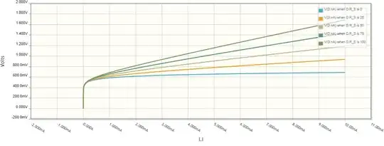

Now we come to the most interesting part of our study - to see what is the influence of R_B on the IV curve. As we expected, it is insignificant because the base current is "beta" times smaller than the collector current; the IV curves are almost horizontal and the same (as they say, the diode differential resistance in this part is lower). That is why the active diode is better than the ordinary diode. This confirms the assumption of @jp314.
Active diode IV curve - Rb var

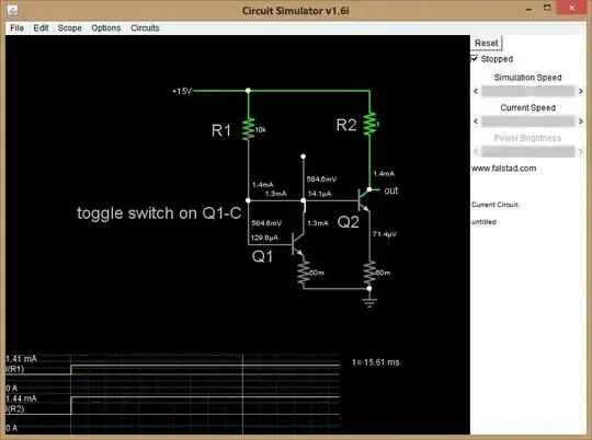

How to mirror the current
This the most important active diode application in electronic circuits (mainly in ICs) where a current from one place is "cloned" to another or more places. Furthermore, the direction of the current is reversed.
"Reversed transistor"
The negative feedback has the unique property to reverse the transistor behavior. Usually, the input voltage Vbe controls the output collector current Ic (see STEP 2.2) while here, thanks to the negative feedback, it seems as if the "input" collector current Iin controls the "output" base-emitter voltage Vout. This is because the transistor adjusts its Vbe voltage to pass the collector current supplied to it by the current source; so it acts as a log current-to-voltage converter.
"Normal transistor"
Then this "output" voltage can be applied as an input Vbe voltage to a "normal" transistor Q2 to convert it to another current Iout = Iin; so it acts as an antilog voltage-to-current converter.
Cascaded transistors
In this way, we obtained a "mirror" copy of the entering input current where the output current has the same magnitude but an opposite direction (again entering instead of exiting). It is interesting that the two cascaded nonlinear converters form a linear converter.
Note: I have used a little "trick" to adjust the collector current to exactly 10 mA - I have set a resistance of 860 ohm of the ammeter.
