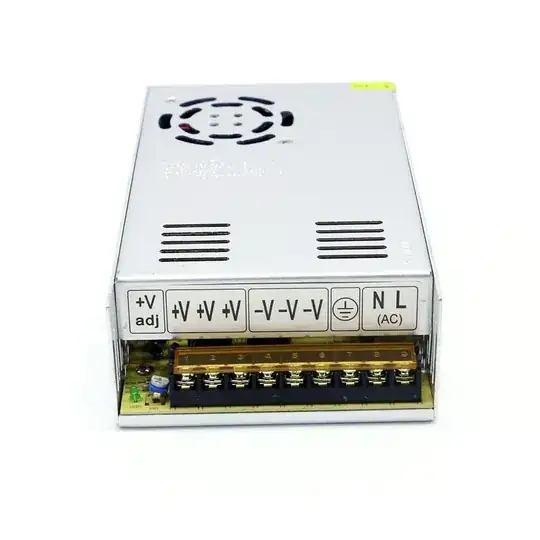

If I used a power supply like this one
Does each split to supply power need to come from another one of the V+?

  • For a 50 A total load, I would split the load into three parts so I could use all three pairs of output terminals on the supply. – Peter Bennett May 26 '22 at 16:04
  • So with a power supply, if you use all three parts, does the current split 3 ways as well? Or does each still receive the full load of say 50amps? – Ryan Wilson May 26 '22 at 16:47

  • Current is what the load will use full out, if it doesn't need it it will not draw it. By splitting the load out several ways you are spreading the load across several wires each carrying approximately the same current but this is dependent on wire size,percentage of load and wire length. The power supply will deliver anywhere from 0 to 50 watts, what the load draws. If you used a 100A power supply for example a 50 Watt load will only draw 50 watts and the power supply will probably run cooler. – Gil May 26 '22 at 18:30
  • @RyanWilson the 3 parts are most likely just connected together - it's not 3 parts, it's 1 part with 3 screws to make it easier to attach 3 wires if you want to. – user253751 May 27 '22 at 14:55
