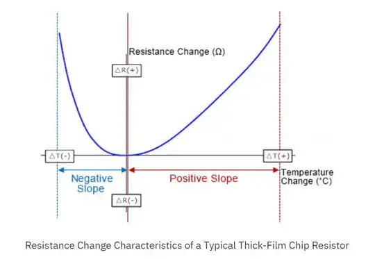

In order to get better performance, resistor makers use materials and constructions that often result in a more complex curve, especially for high precision resistors.
Here, from a major resistor manufacturer (Rohm) is a curve that they say is typical of thick film construction.
The temperature coefficient, when measured as in MIL-STD-202, by default has a reference temperature of 25°C and is measured above and below the reference temperature.
T.C.R. = \$\frac{R_2 - R_1}{R_1(T_2 - T_1)}\cdot\$100
That method appears to assume that the change will be relatively monotonic above and below 25°C. Note that the slope of Rohm's curve, depending on the end measuring points, can be considerably higher than the average T.C.R. specification, especially at the temperature negative extreme in the example shown.
