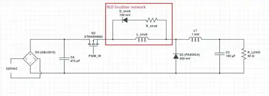

I've tried adding an RLD snubber network after the NMOS source (between Nodes B and C in Fig 2) and the current spikes seems to not be reduced as much. And another thing I need to mention is that when I put the RLD snubber in my circuit, the gate-source voltage is no longer 12V (it increases as the input voltage increases). I'm afraid this may cause damage to my NMOS (as the VGS rating is only 20V). In Fig 4, you see where exactly I put the RLD network in my circuit
Buck converter circuit with RLD network Fig 4. Buck converter circuit with RLD network

Your inductor is saturating.
It appears you are using a green toroidal inductor with only a handful of turns. Any magnetic core that is able to achieve 1mH of inductance with so few turns has very high magnetic permeability. That means that while you can achieve a lot of inductance with relatively few turns, that inductance will saturate at very low currents. There is no way that inductor will handle hundreds of mA, nonetheless 10A.
Green toroid cores like that are typically used to make common mode chokes for EMI suppression. Common mode chokes use two windings with current flowing in opposite directions whose magnetic fields mostly cancel each other out. That means while the inductance is high, the core is subjected to a very weak magnetic field and that is all it is meant to withstand. Such cores are totally unsuitable for power conversion where large DC biases and stronger fields will be present. Simply put, they will not work for your application.
The wire certainly looks like it can handle 10A - so I suspect you chose your inductor based on the maximum DC current spec and not the saturation current. The maximum DC current is determined mainly by the winding wire resistance and size. It doesn't imply anything about if your inductor will even be much of an inductor at that current or not though.
Saturation current is the current at which your inductor has lost 20% of its inductance. Unfortunately, ferrite-based core materials (like those green toroids) do not saturate linearly. They saturate like jello hitting a brick wall at mach 1. Going over the saturation current results in a sharp decrease of the inductor's inductance, essentially approaching what that inductance would be with an air core instead of a magnetic one.
You should understand that ideally you want 30-40% ripple current (an AC current wave form superimposed on the output current through the inductor. This also means you need 1.4 times your output current worth of saturation current, so 14A.)
Ripple current is easily calculated: \$ I_{ripple}= \frac{V_{out}\left (1 - \frac{V_{out}}{V_{in}} \right )}{Lf_{sw}} \$ where L is the inductance and f is the switching frequency.
For your application, that would correspond to about 200uH. There is no advantage to using an inductor as large as you are using, and a 1mH inductor that can withstand 14A of saturation current is impractically large. Even 200uA at 14A is quite big, but such inductors do exist and can be found on Digi-Key.
You may want to consider doubling your switching frequency, as this would reduce the needed inductance in half, albeit at the cost of higher losses in your MOSFET.
Also, snubbers limit voltage spikes, not current spikes. You use them to prevent a voltage spike blowing a hole through a MOSFET's thin and relatively fragile oxide insulating layer.
So there is nothing wrong with your snubber topology - it is just that they won't do anything helpful with regard to current spikes. The only thing that limits current is series resistance (or reactance, or both aka impedance, which you are losing far too much of due to inductor saturation).
