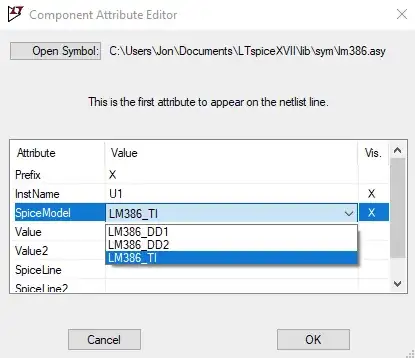

Once you do this, you can fire of LTspice and create a new schematic and use F2 to select the part from the list. Once it is on the schematic, you can right-click the part (at least, in Windows) and see this:
Here, you can move the mouse over the SpiceModel, underneath the Value column where it says "LM386_TI", left-click that line, right-click in the highlighted Value column and select the little drop-down arrow to see:
And there you can see the three LM386 model choices. Pick any one of them you want.

LINE Normal -32 16 -64 16
LINE Normal -32 -16 -64 -16
WINDOW 123 16 0 Center 2
SYMATTR Value2 LM386
SYMATTR Prefix X
SYMATTR Value LM386
SYMATTR SpiceModel LM386.sub
PIN 48 16 LEFT 8
PINATTR PinName g1
PINATTR SpiceOrder 1
PIN -64 -16 BOTTOM 8
PINATTR PinName inn
PINATTR SpiceOrder 2
PIN -64 16 TOP 8
PINATTR PinName inp
PINATTR SpiceOrder 3
PIN -16 48 LEFT 8
PINATTR PinName gnd
PINATTR SpiceOrder 4
PIN 64 0 LEFT 8
PINATTR PinName out
PINATTR SpiceOrder 5
PIN -16 -48 BOTTOM 8
PINATTR PinName vs
PINATTR SpiceOrder 6
PIN 16 32 LEFT 8
PINATTR PinName byp
PINATTR SpiceOrder 7
PIN 48 -16 LEFT 8
PINATTR PinName g8
PINATTR SpiceOrder 8
I wasn't happy with these results so I found a better source, so disregard the above.
https://oshwlab.com/example/Demonstrating_the_EasyEDA_LM386_spice_subckt_model-pgoiAgM4m
