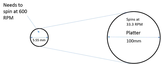

I am trying to make a custom tv remote using an ATmeta328p microcontroller. It contains 28 buttons which are wired in a matrix configuration, resulting in 5 outputs (columns) and 6 inputs (rows). Before ordering a PCB, I want to make sure electrical the circuit which I came up with is going to work, so I have made a similar circuit with only 4 buttons (2 rows and 2 columns) on a piece of perf board to which I can test with an Arduino Uno.
Now I have written the code for it, but the program gives an incorrect correct output when do not I serial print a message at some line which I have used for debugging. If I do not print at a specific line, two buttons on the same row will sometimes not be detected correctly when I press them simultaneously. I have tried to put a delay on the line instead of serial print, but this does not help.
I have put my code below. The message which I need to print for the program to work correctly is on line 35 (Serial.print("\ntest");)

When a button is pressed, the corresponding row becomes low because all column pins are set to low (acting as a GND). If this happens, the row state is stored, and then every column pin will be set to high one by one. If then a specific column pin makes a specific row pin become high again, I should know the row/column position of the button which was pressed.
When I press for example the two buttons on row 0 simultaneously with the printing message in between, I see this on the serial monitor:
test
Buttons:
0 0
1 1
And when I remove the message, I get this on the serial monitor:
Buttons:
0 0
0 0
I am not sure if this problem arises because of the hardware or the software, so I have also put the schematic of the circuit below:
Can someone see what I'm doing wrong?
Roy Meijer
  • 53
    a serial print of "test\n" @9600 bps would take about 5ms if that function call is blocking, perhaps replace the print with a delay(5) to make sure your GPIO circuit isnt magically dependant on the serial port? if that succeeds I'd guess that switch bounce could be causing you troubles, though then your output would be more random and not always 0. Also you mention interrupt a few times, but I see no interrupt service routine - is there one? if there is and you're sharing global variables between the ISR and the main routine be sure to declare them as `volatile varname;` – Bryan May 13 '22 at 22:16
  • I have tried to replace the serial print with a delay, but it did not help. I have tried delay(1) and delay(1000). I do not expect delay(5) will give a different result, but I can try it. The output without the serial print is indeed a bit more random. It is not always 0, but I only showed 0 in this example. There is no interrupt service routine yet, but I'm planning to implement one later when I'm sure this is working correctly. I have called it interrupt because it is the pin which will trigger the isr. – Roy Meijer May 13 '22 at 22:45
    replacing Arduino main() removes Arduino initialization. it is possible delay() doesn't work without it. implement Arduino setup() and loop() and let core do main() – Juraj May 14 '22 at 05:18
    I have already called init() at the start of the main so everything should work correctly. I am sure delay works, because the delay(1000) at the end does stop the program for 1 second. – Roy Meijer May 15 '22 at 14:13
If you press both buttons in a row at the same time, your scanning method by switching the COL outputs creates a kind of soft short circuit. While one COL is high and the other becomes low at ROW0 you have VCC/2 (+ a little from R3 and R5). It's at random what the MCU would read there (no, not random, but hard to predict).
Try to set PORTB to all bits low and scan with the DDRB to switch between output(active low) and input(inactive open drain). This way you avoid ambigous analog levels on the ROW lines and wasted 5mA cross current.
By the way, you don't need R3 and R4 if you activate the internal pullup's of the ROW input port (PORTC-bits high).
Reduce R5 to 10k or lower or you may receive false int low on EMI spikes.
A good solution is using a timer interrupt, read the rows there and and change the active COL for the next int cycle. If you have done all COLs, you can calculate the pressed buttons and set a (volatile) bool flag to inform your main loop. In this polling mode you don't need the int input and you don't waste cpu time on delay(). However, pressing more than one button in such a matrix may produce additional buttons looking pressed, it's the price you pay using a matrix. Just discard results with more than one button pressed.
Some years ago I did the same with an atTiny24 using sleep mode to run it from a coin cell. Well, this is Pascal code with assembly sections and the comments are German, but you may extract some useful ideas out of it.
