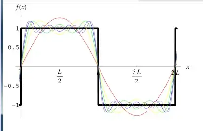

At power on, we have a rising edge like the one in a square wave. That edge contains a lot of frequencies, as can be (partially) seen on this site:
Fourier of a step
Those coloured lines are those frequencies where the capacitor has non-infinite impedance, hence it conducts.
