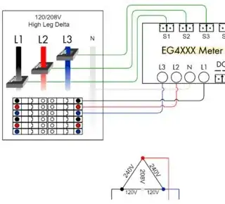

We are using eGuage watthourmeters to monitor the outdoor unit on five VRF systems powered by two different 3P4W 120/208V high-leg delta panels. The neutral is not connected to the outdoor units.
We have connected the meters according to the manufacturer's instructions as shown in the diagram below:
eGuage connection wiring for high leg delta

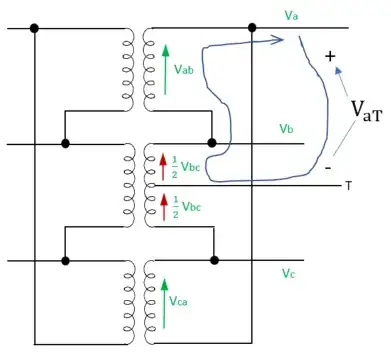

Assuming an A-B-C rotation system, is my assumed connection diagram below correct (including assumed currents being measured)?
Assuming that your terminology "L1-S1 [deg]" refers to the angle by which the current S1 lags the voltage measured from L1 to N (where N is the center tap) I get the following phasor diagram:
It is clear from this diagram that the three currents do not add up to zero - which they must do if no loads are connected between the phases (L1, L2, L3) and the center tap T (I think you call this neutral). Adding these up you get \$3I_0=12.66\angle-19.8° A\$.
Can you correct my assumed connections?
UPDATE 1: Answering question about how derived.
  1. I assumed the system has A-B-C rotation so I can draw the 3 phase-neutral phasors, and from them derive the 3 phase-to-phase phasors. e.g. To find \$V_{ab}\$ just take the \$V_a\$ phasor and subtract the \$V_b\$ phasor from it. To do that negate the \$V_b\$ phasor (flip it 180°) and add it head-to-tail with \$V_a\$).
  1. I wrote the voltage phasors on the connection diagram so it is easier to write KVL (head of the arrow is the +). For example, following the blue path in the figure below - starting at \$V_a\$ at top-right and following a closed path back:
$$+V_{aT} - \frac{1}{2}V_{bc} -V_{ab}=0$$
So,
$$V_{aT} = \frac{1}{2}V_{bc} + V_{ab}=0$$
And letting ph-ph voltage equal 1.0 per unit (e.g. 240V) then we have,
$$V_{aT} = \frac{1}{2}\angle-90° + 1.0\angle30° =\frac{\sqrt3}{2}\angle0° pu =208 V$$
enter image description here $$ $$
Similarly we find,
$$V_{bT} = \frac{1}{2}V_{bc} =\frac{1}{2}\angle-90° pu = 120V$$
$$V_{bT} = -\frac{1}{2}V_{bc} =\frac{1}{2}\angle90° pu = 120V$$
Plotting these 3 guys on the original phasor diagram gives us the following:

  • Because the VcT reference is reverse of a "normal" delta, I believe the angle for Is1 should be leading instead of lagging -- see the updated phasor diagram I added. Otherwise this looks correct. How did you develop these diagrams and do the phasor addition? – LShaver May 07 '22 at 22:02
    Hi @LShaver, i added an update to my answer to show you how i found the voltages & phasor diagram. I'm sorry, i don't understand what you are saying about VcT. Maybe you can take my phasor diagram and edit it to show me - and add to bottom of your question. Also, i'll be traveling all day tomorrow so may be a while for i get back to this...but i will. – relayman357 May 08 '22 at 01:40
  • Looking at your last phasor diagram; in my thinking, when converting a delta to a high leg delta, VaT "maps" to Va, but *both* VbT and VcT map to Vb, except VcT is mirrored. So assuming the currents lag the voltage throughout, when we mirror Ic it the reference switches from lagging to leading. If I'm correct, it would look [like this](https://i.stack.imgur.com/IjXWq.png). – LShaver May 08 '22 at 02:30
  • What matters is the polarity on the CTs. Looking at your top figure I would assume that the polarity marks/dots are facing the same direction for all CTs. I would also assume they are facing toward the transformer. Can you verify? – relayman357 May 08 '22 at 12:29
  • The polarity on the CTs is correct (dots facing load). If you look at the phasor diagram in my (edited) answer you'll see what I mean -- the S1 current *appears* to lead the L1 voltage, but this is because both phasors are a mirror image of the S3/L3 phasors, since they're associated with the same L1-L3 side of the delta. – LShaver May 09 '22 at 01:00
