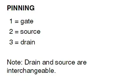

JFETs are typically symmetrical and you can swap source and drain, for example from the J111 datasheet:
