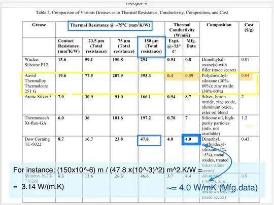

Issue #2 - Paste Conductivity calculation: - It seems to be a conceptual misunderstanding in your text:
…thermal impedance of 0.258 °C-in²/W (TO-3P package area is 15.5x20 mm²) so that gives us Rth= 0.537 °C/W)…
The problem here is that you are not considering the thickness of the thermal paste layer and used equations incorrectly.
The thermal resistance of the paste is proportional to its thickness, where a common dimensional unit would be Watt / (meter x Kelvin).
From Wikipedia’s Thermal Paste, you reach this nice paper from Narumanchi et alli at NREL showing the following data for some heatsink paste/compounds, where I exemplified the comparison between experimental data at given test conditions (t = 150 μm) and the manufacturer’s nominal data:
Heat Flux Equation for Conduction:
Q = (kc / t).A.dT where:
Q = Heat Flux (W).
kc = Thermal Conductivity (W/m.K).
t = Thickness - paste (m).
A = Area under Heat Flux (m^2).
dT = Temperature differential (K).
Reordering for dT:
dT = (Q.t)/(kc.A)
Now, conservatively assuming the cheapest thermal paste (boxed in yellow), with a low-force pressing resulting in a (thick) layer with these following values:
Q = 70W.
t = 0.1mm = 1x10^-4 (m).
kc = 0.4 W/(m.K) (wrongly marked as “W/mK”).
A = 15mm x 20mm = 3x10^-4 (m^2).
dT = (70 x 1x10^-4) / (0.4 x 3x10^-4) = 58°C
Conclusions about thermal paste:
  • Poor paste: In yellow - summing 61°C (transistor) and 58°C (paste), at ambient = 25°C a this leaves just 6°C for the heatsink itself - for 70W, this gives a performance figure of 0.09 °C/W. Not feasible with poor paste.
  • Good paste: In blue - it is ten times better and has kc = 4 W/mK, dT = 6°C. Thermal margin is (150 - (61+6+25)) = 58°C. Then Heatsink = 0.83 °C/W. Feasible heatsink+fan +good_paste, but test if yours is good enough.
