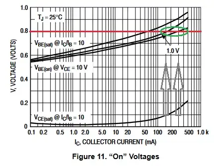

Side note: That base-emitter voltage is a bit high, most likely, for a small signal BJT as it implies a quiescent collector current that is perhaps hundreds of milliamps. See the following chart for the PN2222-D from OnSemi:
Suppose also, we decide that \$I_{_{\text{C}_\text{Q}}}\approx 5\:\text{mA}\$ (which will be about \$30\:\text{mW}\$ for the BJT.)
