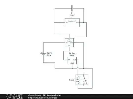

Would a decoupling capacitor across the Raspberry Pi's inputs work to overcome these periods of "startup" servo load? Something like this:
CircuitLab Schematic ufmj8z
(source: circuitlab.com)
If so, what type and size of capacitor should I use for this? Does it make a difference how far from the Raspberry Pi the capacitor is placed (I don't really want to solder one directly to the Pi)?
(Yes, I know, I used a relay symbol to depict the servo in the CircuitLab diagram, but they didn't have a "servo" block. Just imagine it as "thing that draws a lot of current for a very short time".)

A bypass capacitor on the input to the RPi might be enough, but it depends on the duration and magnitude of the dips caused by servos.
I would use an oscilloscope to investigate the dips. If they are very short (us) then I would add arbitrary caps (100uF, 1000uF) and re-test.
Another solution would be to try and confine those peak draw pulses by adding a diode from the battery to the Arduino, then connecting the Vin to the 5V regulator to before the diode. This way, transients won't pull from the input caps of Arduino, only from the battery.

A decoupling capacitor on the RPi will certainly help. Though you will want to get as close as possible to the supply pins. Use an electrolytic and try and find one with the lowest ESR possible.
Analog Devices has some good recommendations:
  • A large electrolytic capacitor (typically 10 µF – 100 µF) no more than 2 in. away from the chip.
    • The purpose of this capacitor is to be a reservoir of charge to supply the instantaneous charge requirements of the circuits locally so the charge need not come through the inductance of the power trace.
  • All decoupling capacitors should connect to a large area low impedance ground plane through a via or short trace to minimize inductance.
Adding a bulk storage cap to the servo would also be a good idea. Again look for low ESR and a value in the thousands of μF.

I had a similar problem with an Arduino powered by 4 NiMH batteries that also drove two servos. Whenever the servos would start or change direction, it would reset the Arduino. I solved the problem by placing a large 4300uF electrolytic cap near the Arduino's Vin & Ground. After using the cap, the arduino never reset no matter what the servo's did.
The Raspberry Pi has a larger current draw than the Arduino. A 4300uF cap may work. You may also want to use two caps, a large one right before the Voltage Regulator, and then another one right before the Raspberry Pi.
Really though, you should use a scope and look at the line. It could be noise (and not a voltage drop) is causing the Rpi to reset. In that case, you'd want to use small filter capacitors (ie 0.1uf) on each servo motor to try an filter the noise.
Gene R
  • 111
  • So I just tried a very similar setup today. A Rpi + Arduino Nano + 7805 Voltage Regulator + 2 Servos (con to bat) + 8 AA NiMH batteries. W/O any capacitors, the Rpi would reset immediately once the servo's did anything. After adding a 3300uF cap across the 8 NimH batteries, the Rpi was a bit more stable, but would still reset most of the time after the servo's started moving. I broke out my scope, and noticed that the 5v line was dropping down to 4v for a few ms when the servo's came on. I added a 2200uF across the output of the 5v regulator, and that seemed to fix the resetting... YMMV.. – Gene R Jun 05 '13 at 05:45
  • Just wanted to add that this is very YMMV. With larger servo's, the 8v line was being pulled down to 6v for a few milliseconds, which is outside of the specs for the LM7805 regulator, which then causes the BOR to trip on the Raspberry Pi, thus resetting it. With smaller 9g servo's, I'm seeing a negligible voltage drop. – Gene R Jun 05 '13 at 18:56
