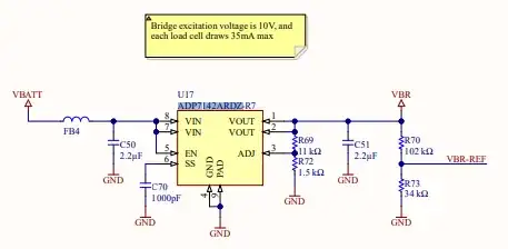

Then I looked at the full schematic :-) In particular the reference voltage used. The circuit choice is strange to say the least. MY MISTAKE The 10V reference is made by dividing down an LDO output. ADP7142 is specified up to an input voltage of 40V but as configured (by R69 and R72) the output should be 41.7V! What input voltage are you giving this part (VBATT)? You are out of specification and the ADP7142 is probably shutting down. END MY MISTAKE The ADC has diagnostic detection which includes checking for a valid reference (>0.7V) which may be disappearing. There's a testpoint you can use to confirm this.
You appear to be providing the ADC with a 10V reference and the ADC is running at AVdd = 3.3V (3.6V max). The reference shouldn't exceed the AVdd.
MY MISTAKE Even if ADP7142 was capable >40V operation, or you changed the resistors to fix the 41.7V issue, END MY MISTAKE the scheme for this reference is far from ideal. There's no capacitance on it. Also there are numerous error sources that mean the accuracy is probably of order +/-3% (presuming 1% resistors, schematic doesn't specify). Your 24bit ADC is using a reference that is 3% accurate. You could happily use an MCUs 12bit ADC for that.
MY MISTAKE Aside from the >40V issue, END MY MISTAKE I'd recommend you look carefully at your references as well as considering what accuracy you need. None of the references looks accurate to better than 1% (haven't checked). You may be able to get a sensible part that has 10V and 2.5V outputs. Otherwise there are cheap 10V and 2.5V regs (0.1% LM4040) and you could divide down and buffer to make the 1.65V reference likely with 0.2% accuracy using 0.1% resistors.
user1228123
  • 183
    "You appear to be providing the ADC with a 10V reference and the ADC is running at AVdd = 3.3V (3.6V max). The reference shouldn't exceed the AVdd." Ouch well... problem found, I would say. ADC tend to get very strange behavior once you've blown 'em up. – Lundin Apr 27 '22 at 10:02
  • Thanks! I think you may have misread the resistor values. U17 powers VBR at 10V (with a 12V input). The reference voltage is 1/4 of that, nominally 2.5V. I've measured all of these rails to confirm they're working as intended. – Tim Vrakas Apr 27 '22 at 18:09
  • Hi Tim. It's not the resistors it's the ADP7142 datasheet that majors on the 5V reference version as opposed to the adjustable version with a 1.2V reference. That changes the output of ADP7142 to 1.2*(1+11/1.5) = 10V. Could it be the soft start of ADP7142 which takes 1ms. If you take a sample in that time the reference will not be valid. Must wait >1ms after EN goes high (i.e. power up). – user1228123 Apr 27 '22 at 19:27

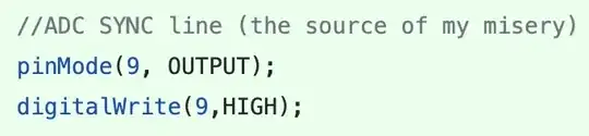

After several months dealing with this issue, the moment of realization came to me at 4 AM as I was drifting off to sleep.
The SYNC Line
The ADC has an external synchronization feature that allows multiple of the chips to be fed with a single synchronization clock, with a guarantee that samples will be taken at a precise interval after the SYNC line goes high. The datasheet does not include clear instructions that the line needs to be pulled up or down if un-used.
The Dev Boards There are two publicly available AnalogDevices dev boards: one for general use with a PMOD header and all pins broken out, and one in an application-specific setup for thermocouple measurements. On the former, the SYNC is wired to a breakout pin, with a pull-up. I didn’t think much of this. On the second however, the SYNC line is tied directly to VCC.
That was strange enough that it sent me back into the datasheet: image from the datasheet describing SYNC functionality
Reading this set off the alarm bells. In particular “held in a reset state” was a potentially bad thing. But wait; how had I connected the SYNC pin on my board? wired directly to the MCU
It’s wired directly to the MCU, without any pull-up or pull-downs. OK, that should be fine. But what are we doing with it in the MCU?
code where nothing is being done with the SYNC line. Nothing.
The SYNC line was floating. When the ADC temperature was higher, some internal parasitic was changing in the chip, and pulling the SYNC line a little higher, causing the ADC to function properly. When the temperature was lower, it would drift down, and cause a permanent reset of the modulator. The digital electronics would still be running perfectly, but ADC itself was stuck in reset.
a trivial digitalWrite() call in the code
A trivial 2-line change to the code caused the issue to immediately be resolved, and it hasn’t been seen since:
Testing with an Ice Cube
I want to thank everyone who responded for your detailed examinations and thorough explorations. There are a number of sub-optimal design choices that came to light, which I may attempt to fix in future versions.
