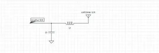

The Arduino Uno is placed upon a quadcopter frame and four ESCs are connected to digital pins 5,6,7 and 8. In the following picture I'll show my radio pinout for both Uno and Nano.
Arduino UNO:
Arduino Nano:

    Apparently EMI gods are not kind to your layout of ground and signals so motor current pulses might be interfering somewhere. Without a full layout and list of assumptions from known good designs and where you deviated might help us. The obvious missing info in schematic is path of all shared grounds. Gnd = local 0V. You don't want motor power sharing lines with signals to the battery. Shielding and filters help – Tony Stewart EE75 Apr 27 '22 at 01:44
  • are the propellers made of metal? – Jasen Слава Україні Apr 27 '22 at 01:50
  • @Jasen, no the propellers are made of plastic. – Alex Foglia Apr 27 '22 at 01:58
  • @TonyStewartEE75 ok, I thought the same but what I found strange is: without propellers, why current flowing through escs does not interfere with the radio module? Anyway, the frame has 4 "arms" and at the center I have the Arduino, a power distribution board and at each arm end I have the ESCs and the brushlesses. Motor LiPo goes to the +/- of the power distribution board, so to the "red and black big cables" of each ESC. Arduino battery + goes to the +5V on the Arduino, Arduino battery - goes to the common gnd. The common gnd is a line where it is also connected ESCs gnd and radio gnd. – Alex Foglia Apr 27 '22 at 02:03
  • The difference between no load and full load can add > 20 dB of noise radiated and conducted and braid connection between the Arduino and the nRF24 module can help for pwr & gnd, twisted pairs for signals or (STP). Regardless , if you can think of a way to measure the fault, use proper measurement techniques – Tony Stewart EE75 Apr 27 '22 at 12:53
    With the propellers, the motors have to work harder because they have a load on them. That means they draw more current, which increases the output ripple of the motor drive circuitry, which increases the radiated noise. This is an unfortunate side effect of driving a motor from an inverter. In industrial applications, they use special shielded cable to connect the motor to the drive electronics. You could also mitigate the problem by adding a filter to the ESC's output, but such a filter would be heavy (bad for copters). Moving the ESCs closer to the motors and using shorter cable may help. – Hearth Apr 27 '22 at 15:18
  • @TonyStewartEE75 i would vote your answer since your hint solved my problem. It was trivial, the Arduino Power supplier and LiPo battery weren't sharing the same GND. Thank you! – Alex Foglia May 04 '22 at 22:50
