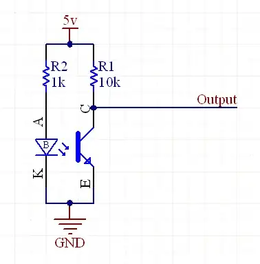

I agree with Anindo Ghosh, an infrared transceiver is one of the best ways to detect these small movements without touching the surface. But I'd like to add some advice on how to use these properly.
Firstly, the one pictured is not the best type. You really need one like this:
Opto transceiver
It's flat on top, meaning that light doesn't leak in and out as much as the more open design.
Secondly, you will need to choose a suitable reflecting surface. Something like shiny metal works very badly because it simply reflects the light right back into the transmitter. The optimal reflective surface is actually white paper, so that some amount of light is scattered sideways into the receiver. So if you can stick a small round white paper sticker onto the back of each key without affecting the sound, then that's a good idea. However, the keys don't look like shiny metal, the actually look a little more diffuse, so you may not need the paper.
Thirdly, the optimum distance to place the reflector: You actually need to select the distance of the device, the current flowing in the LED, and the pull up resistor needed by the phototransistor. Here's how I would go about it. Firstly, choose the LED's resistor by consulting the datasheet for the device. How much current do they recommend for the LED? Next decide on the distance you need between the sensor and the brass. How much do these keys actually move when they're hit? Do they flex a lot? (sometimes things can flex a lot more than you expect).
Cymbal Crash
Once you've determined the distance required so that the brass can't touch the detector, you can choose the pull up resistor for the phototransistor. Choose this value so that the Output signal is 50% of the supply voltage when the brass is stationary.
IR detector circuit
Lastly, you'll probably want to ac-couple the signal from these sensors to the rest of your electronics, so that things like temperature fluctuations don't cause a false detection.
