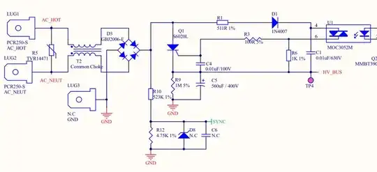

I've made a AC-DC step down buck converter that converts 220 VAC to a variable 45 to 70 VDC at 5 to 10 A to charge a Li-Ion battery. I'm currently using ESP32 to drive a MOSFET driver (IR2110) to drive my NMOS placed at the high side of the circuit. The switching frequency is 20 kHz. I also made a crude closed loop control based on current readings (with ACS712 Hall effect Sensor) to increase or decrease the duty cycle. Below you can see my buck converter and gate driver circuit.
Optocoupler and gate driver circuit Fig 1. Optocoupler and gate driver circuit
Buck Converter Circuit Fig 2. Buck converter circuit. (Do note that the current sensor mentioned above is placed at V_OUT)
My current problem is when the buck converter output is more than 1 or 2 A, the NMOS breaks (it acts as a short circuit), even though the NMOS is rated for 600 V and 40 A, as you can see here in the datasheet.

My questions would be:
  1. Besides the ringing and spiking, are there any more possible reason that can cause said NMOS to fail?
  2. Does the ringing actually harm the NMOS? If not, can I just use an IGBT with 1500 VDC rating to bypass the excess voltage spike?
  3. Are there any mistakes in my circuit design that can cause the NMOS to fail?
  4. If I found a snubber combination that can suppress said spikes and ringing at 5 VDC, will the same combination values work with 311 VDC?

    I am no expert on these circuits, but I wonder about the loop area resulting from having the MOSFET all the way over there. It could invalidate your ringing measurements, I think. – user253751 Apr 21 '22 at 16:13
  • Are you really using a PBR3035 Schottky for the output diode? It has a max repetitive reverse voltage of 35V, so it's quite possible that you're avalanching the diode causing the FET to fail. For 70V output you probably want a 150V diode, maybe an ultrafast instead of a Schottky. – John D Apr 21 '22 at 16:31
  • My bad, I forgot to change the diode name. The diode I'm using is PA905C4 with repetitive reverse voltage of 400V – Kevin Apr 21 '22 at 20:06
    Your snubber is going to be essentially useless mounted on a breadboard off of the PCB. A snubber has to be connected to the ground plane and switch node with absolute minimum series inductance. Having the FET at the end of long leads is asking for big problems due to source and gate inductance. As a minimum you should clean those things up. – John D Apr 21 '22 at 21:22
    I think that very long and thin traces to the FET gate and from driver to FET source are the cause. Also, transmission of PWM signal through simple optocoupler is a bad idea (it is slow), and it is nearly useless (and dangerous!) because signal and power grounds are joined. At my opinion, direct control of SMPS by MCU is very unreliable, it is safer to use dedicated IC with current and voltage feedback and provide its setpoints by MCU. – Vladimir Apr 21 '22 at 22:03

  • Couple of observations: 1. Your design begs for a 4 layer PCB with solid ground plane. 2. Your input and output capacitors ESL and ESR are a problem. You need plastic or ceramic in parallel with them. 3. Placing your MOSFET with long leads that far off the PCB is a recipe for disaster due to stray inductance. 5. Try to shrink the switching loop area down to as small as you possibly can. – winny Apr 22 '22 at 08:38
  • Maybes - both these sometimes work magic in borderline cases: Add a gate-source reverse biased zener with Vzener slightly above max drive voltage. Works wonders to prevent Miller capacitance coupling in inductive spike environments. || Add a gate source reverse biased Schottky diode. Clamps negative ringing excursions and rapidly damps any ringing.. || BOTH diodes should be mounted physically close to FET. – Russell McMahon Apr 26 '22 at 22:59
  • Needlesss to say (hopefully) your Output is lethal and the battery charging circuitry must all always be isolated as if it is at mains potential (because it potentially is) – Russell McMahon Apr 26 '22 at 23:03

This PCB design will not work, even if you think it works. It's an EMI nightmare, and won't be reliable long-term, as various components are likely overstressed due to everything ringing like a bell tower.
One PCB side - top side to make things easiest - should be solely ground. The bottom side should have all the other connections. You'll need to realign the components to minimize current loop areas, and to make it possible to implement the circuit using a 2-layer board with one layer dedicated to a ground plane.
The critical loop areas are:
  1. Gate driver's bootstrap cap through the gate driver chip to the mosfet gate, then source, and back to the driver chip.
  2. C4-Q2-L1-C3 primary loop.
  3. C3-L1-D3 secondary loop.
You should literally draw these loops on the printout of the layout, and estimate their area. The area of high-current loops should be ideally below 1 square inch. The area of the gate driver loop should be 1/4 square inch ideally. The through-hole components of course do you no favors here, but it should be possible to at least close to the target areas with judicious design.
I have no idea what function does the optocoupler serve: it doesn't actually isolate anything, but it does destroy the signal integrity of the PWM waveform for sure.
You probably don't need the bootstrapped high-side gate driver. A basic low-side driver will work fine. The idea is to put ESP32's ground level at the NMOS source. The output voltage can be measured by converting it to a currents that drives a LED-photodiode optocoupler, then using an op-amp to convert the photodiode current to a 0..3V voltage for ESP32's ADC.
I presume that the idea is to have the ESP32 connected via WiFi, so it doesn't matter what exact potential it sits on.
You'd then have a separate ground plane for the ESP32 and the driver circuitry, connected to the NMOS source. The ground plane would be "cut out" from the GND node ground plane.
There are other problems with the circuit design, but other answers mostly cover that.
For diagnosing such circuits, you'll want to integrate various voltage/current buffers, using fast op-amps/differential amplifiers, directly on the board, so that you can then just attach probes to buffered outputs and not worry about the probes adding capacitance/inductance to the circuit. These monitoring circuits will have to be surface mount and a tight layout close to the source of the monitored voltage or current.
Basically, to learn how this works (or not), you'll need to implement instrumentation directly in the design. You can leave it unpopulated for high-volume production, but those components can then be always added for service/maintenance as needed. Ideally, you'd just leave them in - at low volumes (<1000), it makes no difference in product price, as your time has way more impact on the cost.

Turns out, my main inductor (L1) is saturating due to its very high permeability constant. I wound a custom inductor with a permeability factor of 10 with ~200 turns to get 600uH, and the buck converter works as intended.
Although, there's some inconsistency with the driver circuit (heats up and dies randomly), and I ended up changing it to TLP250 for consistent driving capability. I'm not exactly sure why this happened, but from what many people commented on this thread, IR2110 is not suitable for high side driving only
