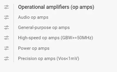

There has been a lot of questions about how to stablise opamp circuits driving capacitive loads. However, I know there are some op amps that are designed to drive capacitive loads but I am struggling to find the search filter criteria to narrow down which opamps would be good at driving capacitive loads. These are the categories found on the analog website. Similarly, TI below. None of the categories specify capacitive driving capabilities as a filter. What are some of the specification of op amps that can help in determining whether or not an opamp will be able to drive a capacitive load?

Putting it in marketing terms rather than engineering terms, what you want is probably something in the "precision op-amp" category. These favor low input offset voltage, as you can see from the fact that they advertise the entire category in terms of Vos and its temperature coefficient. The tradeoff is that gain-bandwidth product and settling time may be worse. You may also need to consider further isolating the capacitive load using a transistor in emitter-follower configuration.
