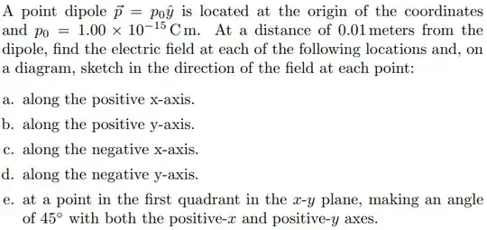

I'm currently taking a course in Electrical fields and circuits and came across this example problem from the course book. I am having trouble figuring out how to solve it. Below you will find my attempt.
From the textbook about point-dipoles

My attempt:
I will be using the following formula to solve the sub-questions a-e. According to my textbook, the electric field due to a "point" dipole is given by $$\bar{E}(\bar{r})=k_{e}\left[\frac{(3\bar{r} \cdot \bar{p})\bar{r}}{r^5} - \frac{\bar{p}}{r^3}\right]. $$
a. Along the positive x-axis, $$\bar{r} = \text{unit vector }\hat{x}$$ $$\bar{p} = p_{0}\hat{y}$$ $$r=0.01 \text{ m}$$
$$ \bar{E}(\bar{r}) = k_{e}\left[\frac{(3\bar{x} \cdot \bar{p})\bar{x}}{r^5} - \frac{\bar{p}}{r^3}\right] = k_{e}\left[\frac{(3p_{0} \cdot \hat{x}\hat{y})\hat{x}}{r^5} - \frac{p_{0}\hat{y}}{r^3}\right] \stackrel{\hat{x}\hat{y}=0}{=} k_{e}\left[-\frac{10^{-15}}{0.01^3} \right] = -9\hat{y}\text{ N/C}.$$
So far, so good according to the key I have available. Our answers match up. Doing the same for c. yields the same result as above and also matches with the key.
Though, when I try to do the same process for b. and d. something goes wrong and I get a completely different answer than the key.
b. Along the positive y-axis, $$\bar{r} = \text{unit vector } \hat{y} $$ $$\bar{p} \text{ and } r \text{ are the same as before.}$$
$$ \bar{E}(\bar{r}) = k_{e}\left[\frac{(3\bar{y} \cdot \bar{p})\bar{y}}{r^5} - \frac{\bar{p}}{r^3}\right] = k_{e}\left[\frac{(3p_{0} \cdot \hat{y}\hat{y})\hat{y}}{r^5} - \frac{p_{0}\hat{y}}{r^3}\right] \stackrel{\hat{y}\hat{y}=1}{=} k_{e}\left[\frac{3p_{0}\hat{y}}{r^5} - \frac{p_{0}\hat{y}}{r^3}\right] = k_{e}\left(\frac{3p_{0}}{r^5} - \frac{p_{0}}{r^3}\right)\hat{y} = 269691\hat{y}\text{ N/C} $$
This is completely incorrect, the key says it should be $$18\hat{y}\text{ N/C}$$ and it's the same for d.. Where am I going wrong?
d. I've tried doing the same process above but with $$\bar{r} = cos(45^{\circ})\hat{x} + sin(45^{\circ})\hat{y}$$ but I end up with the incorrect answer.

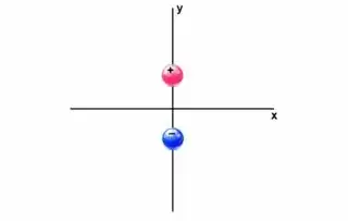

Note: I've added some Glowscript/VPython code to help illustrate the value of using software programming tools. We have so much available to us, provided by many contributors to whom we owe much. Learn well to use the gifts we've been handed by these wonderful people.
Here is what I imagine for the dipole of \$\left(1\times10^{-15}\: C\!\cdot\! m\right)\hat{y}\$. (This might be \$3\frac13\:\text{pC}\$ separated by \$300\:\mu\text{m}\$ to represent your dipole moment, for example.)
(I drew that with Microsoft Paint.)
The field at any point around the above dipole will be the superposition (sum) of the effects of both charges. So:
$$\begin{align*} \vec{E}&=\vec{E}_++\vec{E}_-\\\\&=\frac1{4\pi\epsilon_{_0}}\frac{q_+}{\mid\vec{r}_+\mid^2}\hat{r}_+ + \frac1{4\pi\epsilon_{_0}}\frac{q_-}{\mid\vec{r}_-\mid^2}\hat{r}_-\\\\&=k_e\left[\frac{q_+}{\mid\vec{r}_+\mid^2}\hat{r}_+ + \frac{q_-}{\mid\vec{r}_-\mid^2}\hat{r}_-\right], \text{where }k_e=\frac1{4\pi\epsilon_{_0}}\approx 9\times10^9\:\frac{N\cdot m^2}{C^2} \end{align*}$$
(More exactly, \$k_e\approx 8.98755179\times10^9\:\frac{N\cdot m^2}{C^2}\$)
It's pretty simple.

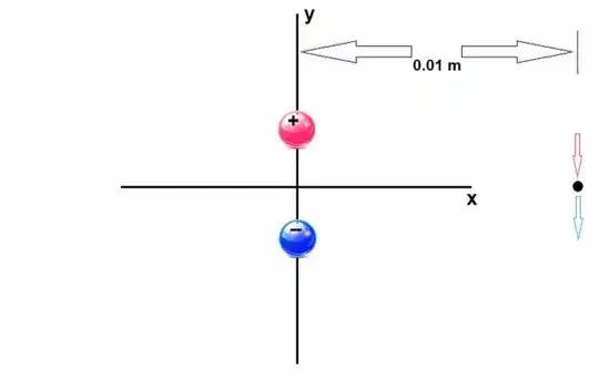

Case (a)
I'd draw it up this way:
At a point \$10\:\text{cm}\$ along the positive x-axis, the magnitudes due to the two charges along \$\hat{x}\$ cancel out, leaving only that caused along \$\hat{y}\$, as shown above in the image. These residuals (are shown in their associated color and direction and they) will add together and point downward, according to the usual conventions. So pointing as \$-\hat{y}\$, or \$\langle 0,-1,0\rangle\$. That's my qualitative expectation.
\$\vec{r}_+=\langle x, 0, 0\rangle-\langle 0, \frac{s}2, 0\rangle=\langle x,-\frac{s}{2},0\rangle\$ and \$\vec{r}_-=\langle x, 0, 0\rangle-\langle 0, -\frac{s}2, 0\rangle=\langle x,\frac{s}{2},0\rangle\$.
\$\hat{r}_+=\frac{\vec{r}_+}{\mid \vec{r}_+\mid}=\frac{\langle x,\,-\frac{s}{2},\,0\rangle}{\sqrt{x^2+\left(-\frac{s}2\right)^2}}=\frac{\langle x,\,-\frac{s}{2},\,0\rangle}{\sqrt{x^2+\left(\frac{s}2\right)^2}}\$ and \$\hat{r}_-=\frac{\vec{r}_-}{\mid \vec{r}_-\mid}=\frac{\langle x,\,\frac{s}{2},\,0\rangle}{\sqrt{x^2+\left(\frac{s}2\right)^2}}\$.
Let's now prove a result:
$$\begin{align*} \vec{E}_\bot&=\vec{E}_++\vec{E}_- \\\\ &=\frac1{4\pi\epsilon_{_0}}\cdot\frac{q}{\left[x^2+\left(\frac{s}2\right)^2\right]}\cdot\frac{\langle x,-\frac{s}2,0\rangle}{\sqrt{x^2+\left(\frac{s}2\right)^2}} + \frac1{4\pi\epsilon_{_0}}\cdot\frac{-q}{\left[x^2+\left(\frac{s}2\right)^2\right]}\cdot\frac{\langle x,\frac{s}2,0\rangle}{\sqrt{x^2+\left(\frac{s}2\right)^2}} \\\\ &=\frac1{4\pi\epsilon_{_0}}\cdot\frac{q}{\left[x^2+\left(\frac{s}2\right)^2\right]^\frac32}\cdot\langle x-x,-\frac{s}2-\frac{s}2,0-0\rangle \\\\ &=\frac1{4\pi\epsilon_{_0}}\cdot\frac{q}{\left[x^2+\left(\frac{s}2\right)^2\right]^\frac32}\cdot\langle 0,-s,0\rangle \\\\ &=\frac1{4\pi\epsilon_{_0}}\cdot\frac{q s}{\left[x^2+\left(\frac{s}2\right)^2\right]^\frac32}\cdot\langle 0,-1,0\rangle \end{align*}$$
There is no information given about the separation \$s\$ of the charges. Only the dipole moment of \$p=q s\$ is given. So, the dipole approximation with \$r=x=10\:\text{cm}\$ leaves you only with:
$$\begin{align*} \mid \vec{E}_\bot\mid&=\left[\frac1{4\pi\epsilon_{_0}}\right]\cdot\frac{q s}{x^3}=\left[9\times10^9\frac{N\cdot m^2}{C^2}\right]\cdot \frac{p}{r^3} \end{align*}$$
And you computed the result correctly as \$9\:\frac{N}{C}\langle 0,-1,0\rangle\$ or \$-9\:\frac{N}{C}\langle 0,1,0\rangle\$.

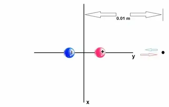

Case (b)
At a point \$10\:\text{cm}\$ along the positive y-axis, the magnitudes due to the two charges along \$\hat{x}\$ are zero and those along \$\hat{y}\$ are shown in the image. (One is larger in magnitude than the other.)
\$\vec{r}_+=\langle 0, y, 0\rangle-\langle 0, \frac{s}2, 0\rangle=\langle 0,y-\frac{s}{2},0\rangle\$ and \$\vec{r}_-=\langle 0, y, 0\rangle-\langle 0, -\frac{s}2, 0\rangle=\langle 0,y+\frac{s}{2},0\rangle\$.
\$\hat{r}_+=\frac{\vec{r}_+}{\mid \vec{r}_+\mid}=\frac{\langle 0,\,y-\frac{s}{2},\,0\rangle}{\sqrt{0^2+\left(y-\frac{s}{2}\right)^2}}=\langle 0,\,1,\,0\rangle\$ and \$\hat{r}_-=\frac{\vec{r}_-}{\mid \vec{r}_-\mid}=\frac{\langle 0,\,y+\frac{s}{2},\,0\rangle}{\sqrt{0^2+\left(y+\frac{s}{2}\right)^2}}=\langle 0,\,1,\,0\rangle\$.
Let's again prove a result:
$$\begin{align*} \vec{E}_\text{on axis}&=\vec{E}_++\vec{E}_- \\\\ &=\frac1{4\pi\epsilon_{_0}}\cdot\frac{q}{\left[\left(y-\frac{s}2\right)^2\right]}\cdot\langle 0,1,0\rangle + \frac1{4\pi\epsilon_{_0}}\cdot\frac{-q}{\left[\left(y+\frac{s}2\right)^2\right]}\cdot\langle 0,1,0\rangle \\\\ &=\frac1{4\pi\epsilon_{_0}}\cdot q\left[\frac{1}{\left[\left(y-\frac{s}2\right)^2\right]} + \frac{-1}{\left[\left(y+\frac{s}2\right)^2\right]}\right]\cdot\langle 0,1,0\rangle \\\\ &=\frac1{4\pi\epsilon_{_0}}\cdot q\left[\frac{\left(y+\frac{s}2\right)^2-\left(y-\frac{s}2\right)^2}{\left[\left(y-\frac{s}2\right)^2\right]\left[\left(y+\frac{s}2\right)^2\right]}\right]\cdot\langle 0,1,0\rangle \\\\ &=\frac1{4\pi\epsilon_{_0}}\cdot\left[\frac{2 q s y}{\left[\left(y-\frac{s}2\right)^2\right]\left[\left(y+\frac{s}2\right)^2\right]}\right]\cdot\langle 0,1,0\rangle \end{align*}$$
Again, there is no information given about the separation \$s\$ of the charges. Only the dipole moment of \$p=q s\$ is given. So, the dipole approximation with \$r=y=10\:\text{cm}\$ leaves you only with:
$$\begin{align*} \mid \vec{E}_\text{on axis}\mid&=\left[\frac1{4\pi\epsilon_{_0}}\right]\cdot\frac{2 q s y}{y^4}=\left[9\times10^9\frac{N\cdot m^2}{C^2}\right]\cdot \frac{2 p}{r^3} \end{align*}$$
Which should be twice as large, in magnitude, as for case (a).
But in this case the sign is positive.

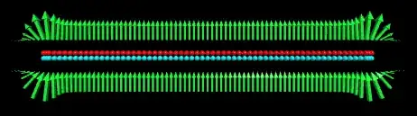

I also did a quick visual simulation using Glowscript (see code here, for example.) Using \$3\frac13\:\text{pC}\$, separated by \$300\:\mu\text{m}\$, made the dipole pretty small in the image:
(That result was achieved using \$9\times 10^9\$ rounded figure and not the more exact figure used in earlier simulations.)
But it gets the point across. I also performed a computation using Python and displayed the value at the bottom. (The arrow with the little red 'star' at its tip is this vector at \$45^\circ\$.) Matches with my expectations, above.

For the above code see here. This outputs:
Pretty nice and easy.
An Added Diversion
The above results ignore the z-axis, so it's really a 2D situation being displayed. However, in 3D the results are symmetrical about the z-axis. Use your imagination for that.
But given the above Python code, it might be fun to investigate a highly simplified capacitor approximated by a simple row of dipoles to see what happens in 2D. The code is here and the results are:
This is not an accurate reflection of how charges distribute themselves on a parallel plate capacitor, as there must be an increasing charge density when approaching the edges, and the above model doesn't accommodate this fact. Instead, it spreads them out completely evenly. Also, the plates are infinitely thin in this example and in reality they are not. (Finite thickness conducting plates must have charge on their outer faces because the line integral of the electrostatic field around any closed path must vanish.) But it is still interesting.
An exaggerated but also illustrative example would be more like this:
For more information on this topic, see "Electric field outside a parallel plate capacitor," by G. W. Parker, 2002, American Journal of Physics, 70(5), 502-507, doi:10.1119/1.1463738.
The point I'd also like to emphasize is the power of using VPython and Glowscript Trinket (tikz stuff) for physics modeling.
In fact, there's a book on the topic of Python generally for physics called, "Essential Python for the Physicist," by Giovanni Moruzzi, 2020.

\$\bar{E}(\bar{r}) = k_{e}\left[ \frac{(3\bar{r} \cdot \bar{p})\bar{r}}{r^5} - \frac{\bar{p}}{r^3} \right]\$
which is the formula I am trying to use, but I have no idea how they got here. No deriving is done from their part.
How did they get the last formula???
