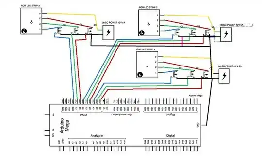

  • @SamGibson I have added the schematic – Naveen Gupta Apr 19 '22 at 09:55
