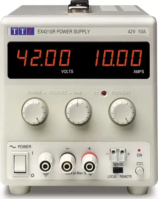

But the ground pin is always connected to the "negative" power supply or the negative part of the battery. This would be like connecting the negative end of the same battery to the GND pin.
power supply
As you can see with an isolated power supply you can connect ground to either positive or negative or neither.
Also conveniently, there's never a "negative power supply" pin. Wouldn't it make more sense to have 3 pins, one for the positive side of the battery, one for the negative side of the battery and an actual ground pin which is attached to a piece of concrete?
Lots of devices have positive, negative, and ground rails. Positive or negative can be the same as ground on some devices, but "never" is wrong. Pretty common to see equipment for example that runs off of +15, -15 and GND.
I suspect a lot of confusion here is the convention of referring to the negative rail as "GND" even when it is not actually grounded. For example, your phone charge has a USB port with a +5 and GND (negative) wire, but no actual ground connection.
Also, I don't even know if the term "negative power supply" even makes sense.
Usually that refers to a power supply that makes a negative voltage relative to ground (or some other reference).
