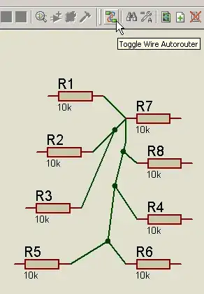

Here another slightly different way that multiple pins are shown on a schematic. (This really doesn't deserve an answer, but it's the only way I could paste the picture in).
