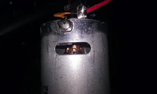

  • Most small DC motors are bidirectional. They reduce armature reaction by shaping the field poles with less air gap in the middle, although that one appears to be tuned for 1 direction. One way to tell (as long as the case doesn't have holes between the poles on 1 side) is to line the armature up so one commutator slot is under the middle of the brush. Tap the ends to allow the armature to line itself exactly. Connect a millivolt meter to the motor and stick a powerful magnet directly over one of the poles. There should be little or no pulse unless you stick the magnet a bit to one side. – Peter R. McMahon Oct 14 '20 at 05:20
  • That method might not work with a 3 segment commutator unless there is a lot of offset. A better way might be, after allowing the armature to line itself up, to look in if possible & check that the slot is still in the middle of the brush. – Peter R. McMahon Oct 14 '20 at 06:10
