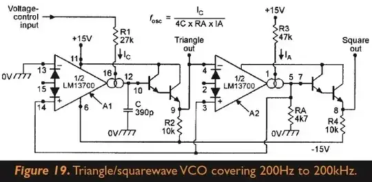

A lot of VCO designs I've found on the internet are quite complicated to build and require the +-12v power supply. Here's an example of one designed to run on two 9v batteries inverted.
358 V/Hz VCO
What I'm looking for is a simple design, not a huge amount of components, V/Octave frequency response and powerable by DC from a battery(or two) (with an audio frequency range somewhere between 20Hz-12.5kHz).

I've just successfully built a VCO. It produces square and triangle wave, can be controlled with voltage (LFO, sequencer, etc) and easy to build. Check out this article. The VCO is at page 10. Even though the schematics implies +-15V (30V) I only used 0-9V. The IC is an LM13700 OTA (operational transconductance amplifier). OTAs are widely used in analog synths since voltage control can be realised easily. An OTA is a kind of op amp with a few extra features. You can build a VCO, VCA and VCF using these ICs and in the Marston-article there are example schematics for all the three. OTA VCO from Ray Marston's article (Nuts&Volts)

  • Here's a circuit I've tried unsuccesfully on +/-9v using two pp3 batteries. I'd very much like to adapt it to 9v http://electro-music.com/forum/topic-41483.html – blarg Mar 22 '13 at 08:50
  • This is a linear Hz per volt circuit and is not suitable for a music synthesizer. It needs to be Octave per volt i.e. the frequency doubles for every volt increase on the VCO input or put another way each semitone increase is brought about by an identical increase in input voltage - at 100Hz, a semitone higher is 105.9Hz, the next semitone higher is 112.2Hz - the new step being 6.3Hz as opposed to 5.9Hz for the first step. – Andy aka Mar 22 '13 at 09:04
  • I've since got it working on +/- 12v and built a 1v per octave exponential convertor for control. Control is provided by MIDI to CV using an Arduino with DAC IC. – blarg May 21 '13 at 15:11
