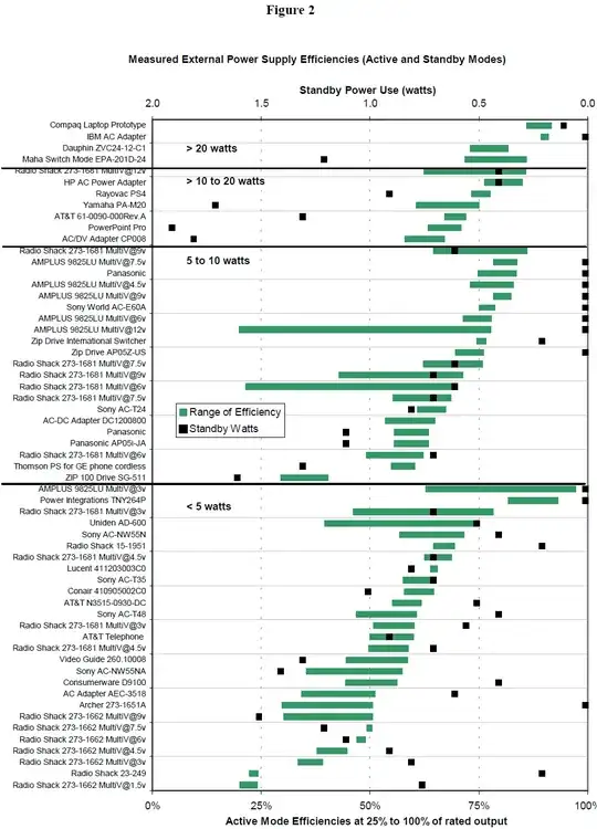

From the couple transformers I've looked at on Digi-Key, all the Energy Star level IV and V transformers have a maximum of 0.5 W usage at no-load.
Energy Star has a whole report on this, and fancy graph (on page 5):
