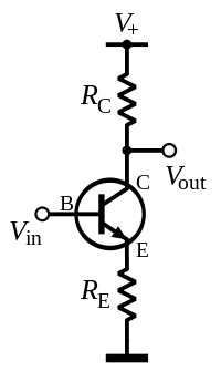

This voltage-doubler is not very good with a low frequency and very large output cap.
But the output impedance is dependant on dV/Ic=dt/C and your RC timer T= 10k 100nF= 1ms with about 70% * 1/T = 700Hz and Zc= 1/ 2pifC= 1/ (6.28 * 700Hz * 1e-7) = 2k2 ohms with 3rd harmonic = Zc/3. Thus even 1k will drop the voltage > 10%.
So if you want decent load regulation at 100 Ohms then the cap must be <5% of Zc(f) or 5 Ohms. Then make both caps the same !
  1. Try > 70 kHz or 100x faster. Change 100 nF to 1nF
  2. Change (cap impedance=) Zc1(f) from 2k2 to 5 ohms or 2% of present. Since rising f reduces Zc to 1% consider both 15 uF or both 33 uF.
    • But watch out for startup heat and use low ESR type caps. ( <0.3 ohms instead of > 3 Ohms)
    • D2 diode will dissipate a few watts for a few seconds into 1 mF on startup if your supply doesn't cut out.
Conclusion
  • Now you can get 80 mA @ 8 V which is still poor performance @ 70 kHz with Si power diodes of 1.4 V drops with 8.6 V with 1k load using two low ESR 33 uF caps from a 5 V, 12 W supply ( W which may be exceeded on startup)
Recommendation
  • Charge pumps tend to use 0.1 uF ceramic caps and operate > 1 MHz but may be you want to define your DESIGN SPECS and consider something better like a boost converter.
  • I'm mostly interrested in how to explain the phenomena; i'm not really following the first part of your explanation, could you ellaborate on the main reasons for the drop at the output,, in regards to the load and the frequency ? – JeanMi Mar 16 '22 at 08:11
