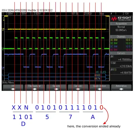

Alright, guys. I found the solution.
Basically, all of you gave me very useful hints on how to troubleshoot my problem.
As I told @asdfex, after evaluating the SPI data bit by bit, I realised that my ADC digital code was embedded into the serial stream captured by the MCU (and the DSO, of course).
If we take a closer look at the data, we have the following disection. Please keep in mind that we are injecting 3.36V or 0xAC0 (for those who speak 12-bit hexadecimal, We have to be inclusive here ;) ).
SPI Data analysis
Since we need to form a 12-bit word, where the MSB is transmitted right after the null bit (NB). The datasheet indicates a maximum of 2 clock cycles for the conversion time, before the NB. Then, we should count 12 bits however, we have 13. Therefore, the last bit (zero) should indicate that the conversion had already finished while CS was still low. The datasheet clearly stipulates this (see the first timings diagram that I shared).
Therefore, we must mask the upper 3 bits and do a shift right to get the final value.
Based on the results from the image, we have:
(0xD57A) & (0x1FFF) = 0x157A
then by shifting one position to the right we get:
0x157A >> 1 = 0xABD, obtaining our 12-bit word, which numerically corresponds to:
0xABD (HEX) = 2749/4095 (DEC) = (671.306E-3)(5V) = 3.356V. Et voila! Pretty close to the expected value. *Please read EDIT 2
Please also note that the serial decode is counting the absolute maximum of 16 clocks, which is in line with the datasheet.
I have confirmed this solution with different voltages and the next step is to feed an analog signal and start digitising some stuff.
[EDIT] I forgot to mention that the final serial values were captured after moving the input voltage to 2.5V
[EDIT 2] Thanks to @G36 who pointed out my mistake. The conversion value should be done over 4096 (2^12). Therefore, the actual measured voltage was: 3.355V.
Final SPI protocol and word formation
