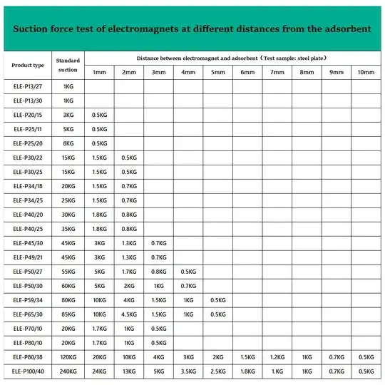

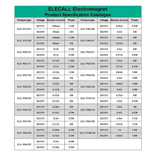

Here's an example electromagnet you can buy: ELECALL electromagnet.
The datasheet shows that the most powerful model (the ELE-P100/40) can run at 12 volts at 1 amp (12 Watts).
datasheet
The lifting force at various heights is shown in this datasheet:
datasheet2
So it can lift a 24kg weight (attached to a metal plate) from a height of 1mm.
It can lift:
  • 13kg at 2mm
  • 5kg at 3mm
  • 3.5kg at 4mm
  • 2.5kg at 5mm
  • 1.8kg at 6mm
  • 1.?kg at 7mm
  • 1kg at 8mm
  • 0.7kg at 9mm
  • 0.5kg at 10mm
Plot these numbers using excel, and then add a 'power' trendline. It gives the equation y=48.246x^(-1.908). This is close to an inverse square relationship, however it will go to an inverse cube relationship beyond a certain point (I'm just not sure where that point would be).
Assuming the inverse square relationship still holds, it appears to be possible that you could pick up a 1 gram paper clip at a distance of 7 inches (however I think the inverse cube relationship will kick in before you get to that height). You would have to experiment to see if it is possible.
