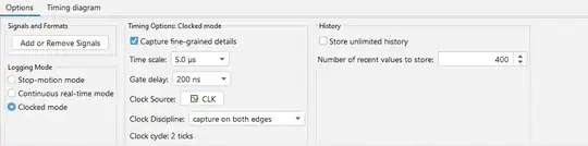

Here are the timing options I ran the simulation with at 8Hz clk. Timing options

I changed the gate delay to 1µs and the timing scale to 10µs to enhance the glitches Output 2
I still do not understand what exactly is causing those high and low spikes in the output and how to eliminate it.

  • I'm talking about the gates G1 and G2 in the original diagram. You have obviously already realized that their delays have something to do with the problem, since you increased the gate delays to "enhance the glitches". Now take a closer look at what they're actually doing. Note that "gate delay" also refers to the clock-to-output delay of the DFFs. – Dave Tweed Mar 13 '22 at 11:29

You can see from the timing diagram that the X glitches occur when the outputs of DFF_A and DFF_B both change level, on the same clock edge.
You can then follow through the effect on the gates that DFF_A and DFF_B drive.
Remember that the model you have is trying to model real circuits as best it can. In real digital circuitry, the two DFF outputs will not change literally simultaneously from the same clock. There will be slightly different responses from each circuit, different propagation delays along the connection in and out of the DFFs etc. Models either ignore these delays completely or try to emphasise them by showing large glitches. Here, your combinatorial gate settling time shows the uncertainty in the outputs as both DFF outputs change across each other, one rising and one falling.
Glitches in combinatorial logic circuits are unwanted transient output states. They are caused when the inputs are at intermediate states before reaching their final states.
