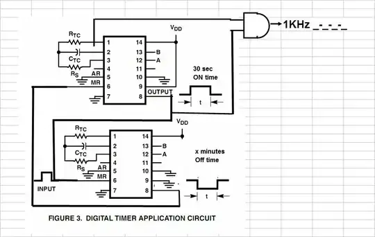

I am trying to build a differential amplifier using the lm741 op amp, and simulate it in LTSpice. The dynamic range of the output is too small (about 20mV), I use a rectangular wave (3.3V) and 1.8V DC Input and want to amplify this input difference. Anybody knows the reason, why the output dynamic range is too small? Thanks in advance, Ahmedenter image description here

From looking at the schematic, I'm assuming that vdd5 is 5V.
The amplifier has a gain of 7. So the difference between the vdd1.8 node (1.8V) and in- node will be multiplied by 7.
The signal coming to in- node is a pulse train. Let's analyse it:
  • When the signal is zero the difference signal will be 1.8 - 0 = 1.8V. Expected output is 1.8 x 7 = 12.6V.
  • When the signal is -3.3V the difference signal will be 1.8 - (-3.3) = 5V. Expected output is 5 x 7 = 35V.
As you can see, in either case, the output will exceed the supply voltage of op amp, which is presumably 5V. The LM741 is not a rail-to-rail op amp thus the output will be (probably a few hundreds of millivolts) less than 5V. So the circuit behaves as expected.
Decrease the pulse train's amplitude and increase the supply voltage because none of the 741's are supposed to be supplied from 5V.

You're using the poor 741 way beyond what it can do: switching at 1 MHz. If you'll go to My Documents/LTspiceXVII/examples/Educational/ you'll see LM741.asc. It's a transistor level representation. If you then change the input source to be PULSE(0 1 0 10n 10n 0.5u 1u) and simulate for .tran 10u, you'll see a more likely output of how the opamp should behave. Not only it's not a comparator, but it's a very fat and lazy opamp, too. What you have there is not a god model. Caveat emptor: always test your models.

Here is what the output should look like (roughly) with an LM741, but I've changed the supplies to +40/-4 and reduced the frequency to 1kHz, a more reasonable frequency for the LM741 and square waves.
The peak output voltage is 7 * (1.8 + 3.25) = 35.35V. The minimum is 7 * 1.8 = 12.6V (a popular vacuum tube heater voltage at one time).
A 741 will barely manage to output a sickly low-amplitude triangle wave if you feed it with a large square wave input at 1MHz. It's orders of magnitude away from being capable of handling that kind of frequency. In fact you'd need a very high frequency op-amp to amplify a 1MHz square wave x 7 and have it come out looking more or less like a square wave. Perhaps 70 MHz gain bandwidth, and adequate slew rate vs. about 1MHz GBW for the 741.
What you are seeing in the simulation is just some internal coupling at low amplitude. The op-amp is doing nothing of value (it's railed).
