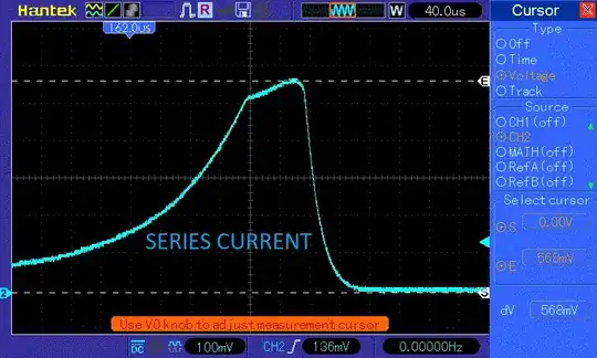

MOBO powered from DCIN, it's connector. Series current, 100mV/A, 568mV corresponds to around 5.7A Series current
From bird-eye view the current form looks like the following:

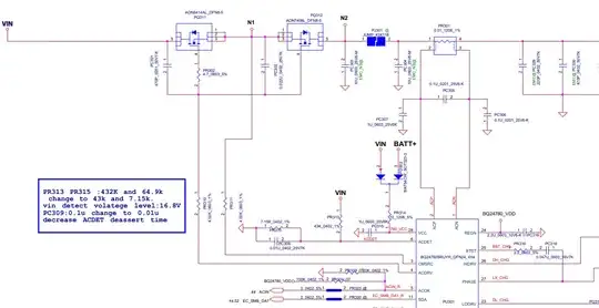

  1. Maybe there is a shorted capacitor. I have checked a couple of points on the circuit. Mainly it's input stage but nothing i have found. Also thinking of a short the component which malfunctions might heat up. With my thermal camera i didn't find anything hotter then +40°C (voltage rails are present so the DC/DC converters are doing something)

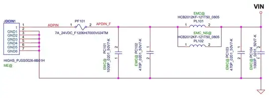

Here is the input stage: input_stage
Here is where VIN goes,high side swtiching mosfets: high_side_switch_mosfets
Voltage injection: I started injecting 5V after the switching mosfets(PQ311,PQ312) with current limit to see if i found the short. There was no high current so
-I injected 18.5V to PJ301 (basically N2) and the MOBO's POWER LED was lit.
-Injected 18.5V on N1 and the power led was lit
Voltage injected on either N1 or N2 produces the following current waveform: voltage_onN1_or_onN2 When the led is blinking the current is at on the wave's top part(at the level of the menu text MATH(OFF)). When the current is at "cursor S" the led is OFF constantly. To me without thinking much about it it looks like the MOBO is working and managing itself.
-Injected 18.5V on VIN then MOBO is not working but shorting PQ311(source and drain together) "does the trick" and MOBO works.
I have replaced PQ311 as came to the conclusion i had no better idea at that point. Changing PQ311 has not solved the problem, i was feeling it won't but anyway proceeded with chaning. I tested components connected to VIN if they are shorted or something but not found any suspicious.

  • Have you checked the condition of PR301? At 0.01R it'll be difficult to test, but your waveform showing ACDRV & series current makes me wonder if the BQ24780 thinks it's detecting an over-current condition (measuring the voltage across PR301) and trying to shut down. You could try bridging over PR301 pins 2 & 3 or PC305 with a short jumper wire to see if that makes the BQ IC happy. – brhans Mar 03 '22 at 01:54

Repair tech here! Solid analysis. I advise against injecting 18V, because your main power bus of the board is probably 12V or so, and there is a chance that the switching MOSFET that converts it to 12V is burnt through, so your main power bus voltage becomes 18V instead of 12V. This correlates with the laptop turning on, because all the other voltage converters can often survive short-term overvoltage, I've seen it myself.
You never mentioned the model of your laptop and what kind of power draw one could expect (at least how many watts your charger is, it gives some estimate on what to expect - bear in mind it's battery charging + board draw).
PQ311/312 are not switching mosfets, they are charger isolation mosfets (and there is no inductor, a dead giveaway). Notice they're back to back, blocking current in both directions. If there is lack of info, it's actually an acceptable (but not perfect) solution to just bypass them with thick enough wire. But don't do that just yet, because of possible burn-through of 18V to 12V. If that's the case, it's not an acceptable solution.
Power cycling usually means there is most likely a short on one of the secondary power lines (or current sensing circuit, but that comes only with water damage), at least it appears at some point when lines turn on, so the whole thing resets. Look for coils/inductors on the board and beep them to the ground. Without looking at the schematic. Just look around the board and probe stuff. CPU/GPU power lines have little impedance, so they will always beep (they're beefy and are right near CPU/GPU), but you can measure voltage on them. If anything other than CPU/GPU power beeps, it's worth measuring voltage there.
For now, follow the power line after the isolation MOSFETs, find the main power buck converter and check if it's doing OK, including its switching MOSFETs (beep drain to source and back). Check the voltage on the main power line when you try to turn it on, as well as on 5V and 3.3V supplies, which you should be able to find in schematic.
EDIT as to where this supposed short disappears when you bypass the isolation - some voltage converters may not receive signal to start switching when you bypass isolation, this is highly individual for every laptop. If there is a burn-through of the high side switching mosfet, the lower side mosfet simply never turns on and the upper one passes full voltage through permanently, so the thing turns on as if there is no short. The short happens when under normal operation without bypass, the converter starts switching and the lower side switching mosfet turns on, while the upper one is burnt through and conducts as well.
