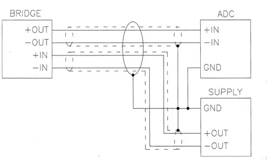

What is the right type of diagram that provides a circuit diagram with the corresponding position?
Generally speaking, it's called a "wiring diagram".
For example, these images".
For example:
Wiring diagram from Wikipedia {Wikipedia}
In the specific case of a PCB, it's called a "PCB layout"
For example:
PCB layout source
