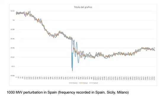

The frequency trend is similar but not equal in two different distant points of the network after a perturbation. The trends are different in amplitude and time, and this is due to numerous variables (inertia, control actions, different damping, etc...). To summarize, it is different because the electric grid is a very complex system with several variables and regulatory actions involved. But at steady-state, the frequency will have the same value due to the fact that the electric grid is synchronized. In the picture, there is an example of 3 different frequency behavior after an imbalance of 1 GW in Spain: enter image description here
  • Was the 1 GW a change in a load or source? Also, what's the source? I'd love to explore this dataset. – LShaver Feb 25 '22 at 15:12

    @LShaver unfortunatelly I don't know what is the source, I took it from notes of my past course of Electric Power System. It was given by my professor in the slides. I want to find a source to check the frequency too, I cannot find it :( If anyone knows a source to check the frequency please tell us – Samuele Benito Di Gioia Feb 25 '22 at 17:16
