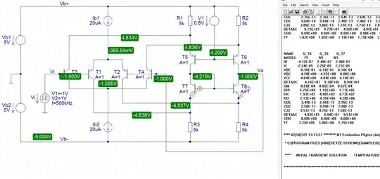

edit* I've attached a simulation right out of the text you mentioned (tietze-shenk). I do not have the book, but the authors share their simulations on their website.
If you look at the collector currents in \$T_7\$ and \$T_8\$, you notice they are practically identical. This is because the circuit is balanced at the operating point with the same currents dividing equally into all branches. And \$I_o\$ will just be 0 because they are balanced (not \$4I_q\$). If you do anything to disturb that point (i.e. differential input other than 0 or inject a difference current into input branches or sources/sinks - like the author shows), the branch currents will no longer be equal, but the node currents must still follow kirchoff's law at any time. It looks (from your diagram, again I don't have that text), that the author is using an explicit current imbalance at the input to show this.
edit** I looked at a preview of the book and there do appear to be typos/edit mistakes (\$I_{T_3}\$ should be \$I_o+I_q\$). This might possibly be a typo as well, without book in hand, I can't say for sure.
