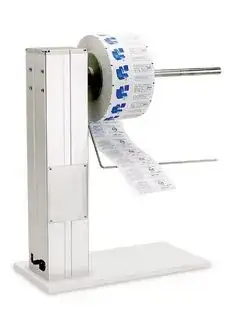

In industry this would be referred to as a dancer-controlled unwind system.
Figure 1. A label unwind stand with dancer-controlled motor. Image source: AZCO.
A longer dancer arm will give you more torque for a given thread tension. This one, for example, has a long lever and a maximum actuation force of 1.5 N (0.15 kg). If this is too much then consider an optical or inductive proximity switch to give contactless monitoring of the dancer position.
For engineering you need numbers. Get a digital kitchen scales or similar, put an object on it, tare the scales and pull the thread down both sides of the object with the maximum tension your want. Record the measurement in kg. Multiply by 10 (9.81 m/s/s) to convert to newtons (N). Then look at the switch specifications and see if it is sensitive enough.

  • Thanks for your reply! I learnt a lot today. The push-button with lever I mentioned in my original question is the same microswitch type as the one you linked, except it has a smaller lever. I could try to extend the lever and see if it is actuated when the pump pulls on the thread. – Joe Jan 29 '22 at 22:03
  • @Joe: See the update on tension measurement. – Transistor Jan 29 '22 at 22:13
