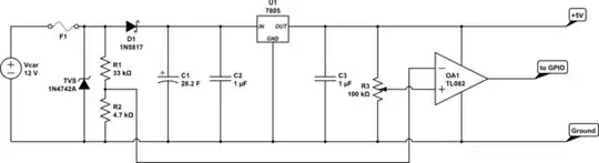

Does this look correct and sufficient?
second draft
The circuit will be powered by a car battery - 12.6 to 11.7V. The Raspberry Pi takes 5V (5.25 to 4.75V) and draws 700-1200mA. I haven't timed it yet, but I'm guessing the shut-down process probably takes around 5 seconds.

I'm not intimately familiar with the behavior of the Raspberry Pi for shutdown and power usage, so I'll mainly rely on the numbers you gave and leave the formulas.
The exponential discharge curve you show is for a resistor-capacitor circuit, but the linear regulator causes things to act a bit differently. Suppose the RPi always consumes the maximum current you stated: 1200 mA. In this case, that current always flows through the regulator, and the effective resistance of the circuit is constantly changing (decreasing) as the capacitor discharges. This is true as long as we are in the operating range of the linear regulator, which is fine because we need the RPi shut down before we hit that region.
The differential equation for a capacitor is: $$I=C\dfrac{dV}{dt}$$ which can be rearranged to solve for C: $$C=I\dfrac{dt}{dV}$$
  • I is simply the average current for the RPi. In this case, we will assume it is 1200 mA, or 1.2 A.
  • dt is the time it takes to shut down the RPi. Using your example, this is 5 s.
  • dV is the change in capacitor voltage. We'll assume that the starting voltage is the lowest specified voltage of 11.7 V, and that the ending voltage is 7.0 V. I'm setting the end voltage to 7.0 V because the 7805 linear regulator requires two volts headroom for proper operation (5.0 V + 2.0 V = 7.0 V). This makes dV = 11.7 V - 7.0 V = 4.7 V.
This gives the following result: $$C=1.2A\dfrac{5s}{4.7V}=1.28 F$$
Yes, that's 1.28 Farads (no micro or milli here). This would likely involve buying several low-voltage caps and placing them in series
So then the other issue is your circuit - it won't work the way you want it to, because the only way the positive input of the comparator gets close to the negative input voltage (so the output can change) is when your input voltage is already dead. As designed, the comparator would never switch.
What you want to do is measure your input voltage, before the capacitors and diode, and compare that voltage with a "reference" that you can set with a trim pot. See example circuit below:

  • You're right - I meant to feed the positive input of the comparator from the other side of the diode D1. I need the GPIO pin to trigger an interrupt the moment the 12V supply is disconnected (the radio and accessories are turned off). ...So the reference voltage is 0, isn't it? What's the purpose of the TVS diode? – Nicholas Albion Mar 12 '13 at 02:42
