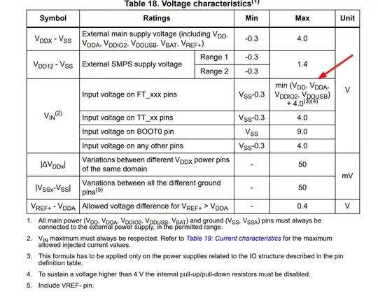

The absolute maximum input voltage is min(VDD, VDDA, VDDIO2, VDDUSB) + 4.0 with some notes.
It does not appear to me that it's safe to apply 5V to the pin if min(VDD, VDDA, VDDIO2, VDDUSB) < 1V.
In other words, supply sequencing may be necessary to ensure that the 3.3V supply is not absent with the 5V supply present. (Or, you could just use a level translator that has two Vdd pins and is designed for this kind of application).

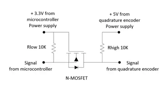

What you need is a bi-directional voltage level converter between 3.3V and 5V. You can find additional information in this stackexchange post: Is there any bidirectional 5v-3.3v level shifter? If you search the internet for “3.3V to 5V level shifter bidirectional IC” you will find several companies with integrated circuits that do the job.
Basically the circuit works like this:
• On one side you have the 3.3V from the power supply of the microcontroller feeding its 3.3V level signal.
• On the other side you have the 5V from the power supply of the quadrature encoder feeding the level 5V signal.
• In the middle you have a transistor (BJT or MOSFET) to isolate them and provide the correct voltage to the other side.
• The ground of both power supplies (3.3V and 5V) are common.
• Here is the final circuit. Please note the substrate diode direction. You want it to be forward biased from the 3.3V to 5V and in reversed biased from the 5V to 3.3V.
• When the signal from the microcontroller is high (3.3V) the MOSFET is OFF and the signal on the quadrature encoder is pulled-up (5V) by the Rhigh resistor.
• When the signal from the microcontroller is low (0V) the MOSFET is ON and the signal on the quadrature encoder is pulled-down (0V) by the MOSFET.
• When the signal from the quadrature encoder is low (0V) the substrate diode pulls the signal from the microcontroller low (0V) ) turning the MOSFET ON.
• When the signal quadrature encoder is (5V) the MOSFET source pin is pulled up by the 3.3V and the MOSFET is OFF.
• Note: This works for open collector type of gates.

  • Why bidirectional? How can you tell that there are inputs to the encoder from the MCU? – Lundin Jan 28 '22 at 10:12
  • @Lundin, the circuit will work with traffic from either side of the connection. If there is no traffic from one of the sides it won't alter the functionality of the circuit. In case of traffic from only one side, with some modifications, the MOSFET can be replaced by a BJT transistor. – VictorTito Jan 28 '22 at 16:13
